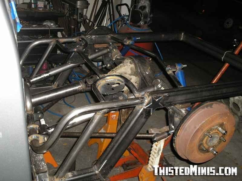

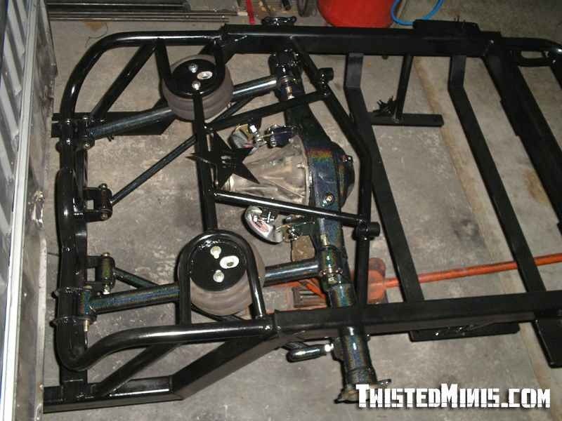

I did it with 1.75" DOM .188 wall.
No gussets on the bar. I welded the plate to the bar to keep the bag from rocking side to side. And I put a 3/4" hole through the center of the bar so that I could weld in a piece of 3/4" .188 wall tube for the bolt to go through. You can see it on the bottom of the bar in this picture.
