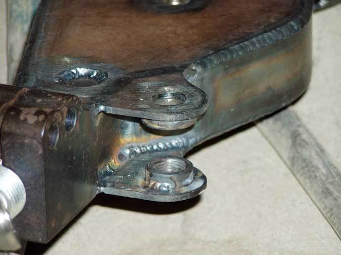

Where did you get the bolts and weldnuts used on this setup? Are they locknuts? This is one of the cleanest setups I have ever seen!! Thanks for the inspiration!

I made the tapered tabs and the threaded bungs are all grade 8 nuts that I turned down on the lathe and chamfered the edges. None of the threads are a locking type so everything will have loctite on it.
There is more time in that front suspension than you would believe. But, you noticing the details makes it all worth while.

Awesome. Im gonna try to do something similar on my tabs, I just dont have access to a lathe so Ill have to get creative.
