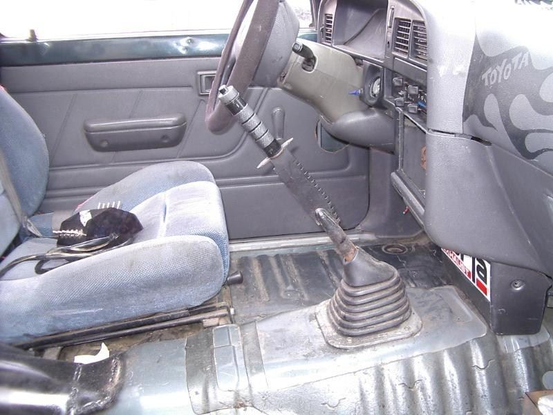

THE SHIFTERS ARE ALUMINUM? I DIDNT NOTICE, AND I WELDED MINE WITH FLUX CORE STEEL WIRE. IT WORKED GOOD I JUST CUT THE END OFF AND ELDED A KNIFE TO IT

i spliced two together in my toyota and they are for sure NOT aluminum
