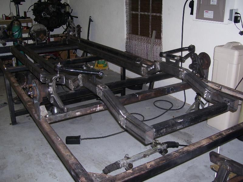

Max Im about to start building a full tube chassis and want to build all of the front suspension as well. What is a good book to buy that would help me with figuring out the front end geometry? Im thinking of using Yota spindles. Do you reccommend any thing else?

i used toyota spindles on my 4runner chassis....i went ahead and used fords idea for geometry and that is lining up all th pivots point for the front suspension.....you can draw a line through the pivots of LCA, steering tie rods,& UCA......it is the same principle used on the mustang II suspension but you get the benefit of a taller spindle from toyota...plus i am abe to use a rack and pinion...my choice was a t-bird....and for uppers i went with afco nascar arms and i made my lowers
