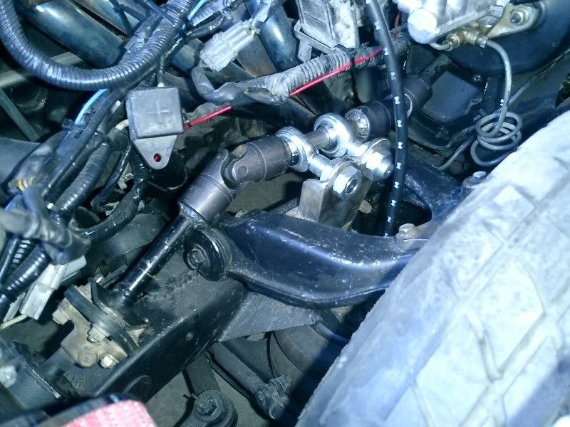

i stock floored and zd frame, now my problem is the steering shaft is to long. i am curious what yall have done to correct this problem and if you have had any other problems to deal with?
jeremiah
cut the shaft to the length you need and add a coupler to it, or a u-joint if you need it. summitracing.com, jegs.com, speedwaymotors.com all sell u joints, and couplers for steering shafts.
scotto79
http://www.dansperformanceparts.com/
go to this site, they have a few different sizes, and a lot cheaper that Summit and Jeg's
I used their u-joint when I dropped my Mazda
