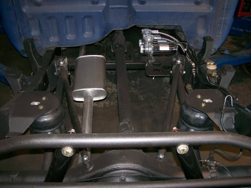

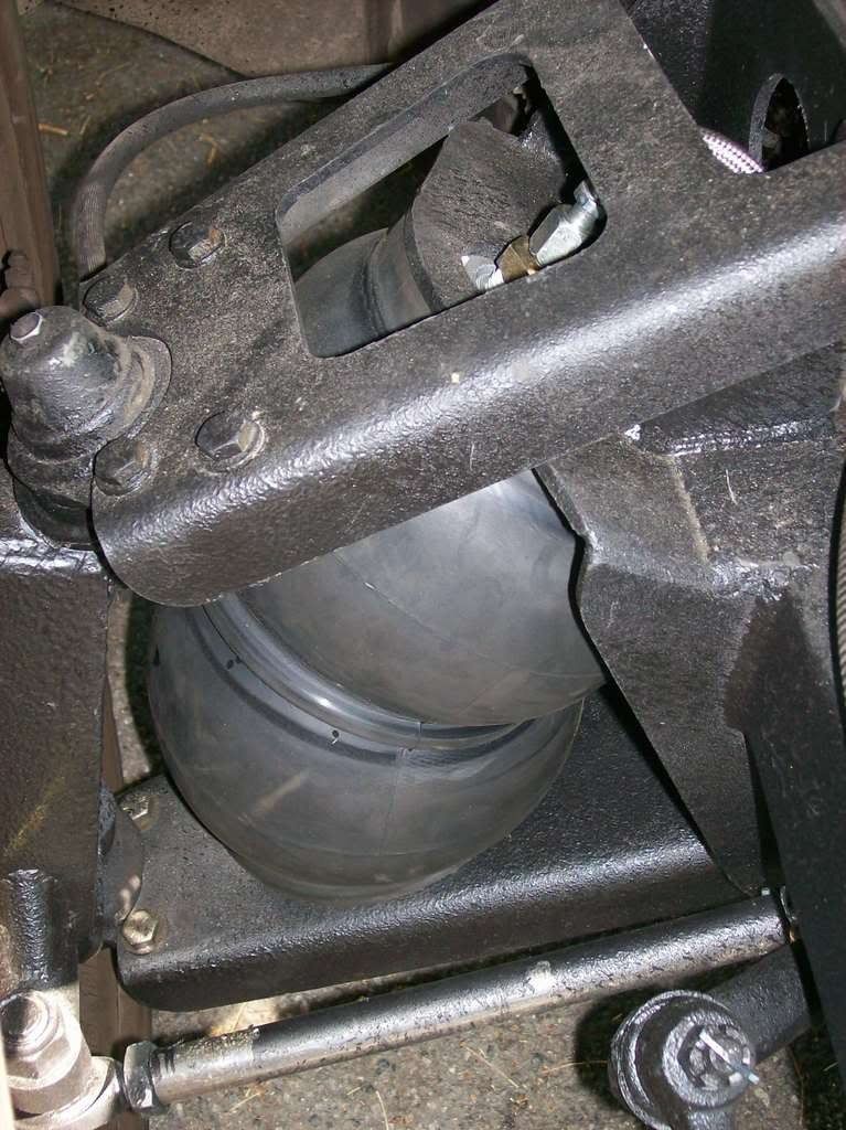

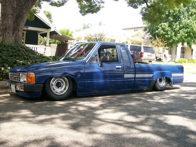

ust posting a vid of my 1986 Toyota ex-cab long bed 3/8 Asco valves & 1/4 steel braided line for all to check out!
lost cause's avatar
lost cause
Nice,..any pics of the set up
kenyken83
yeah here you go....

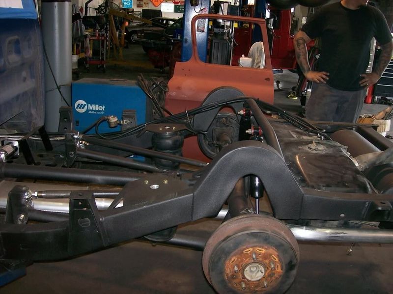

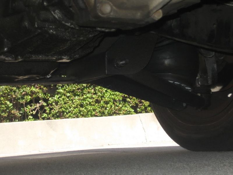

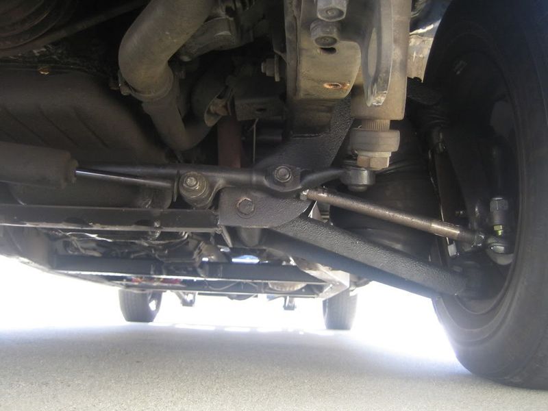

Sweet truck, clean setup! But why are your upper 4 link bar mounting points horizontal instead of vertical? I guess the joint has enough travel but it seems like there would be less stess on the heim joint with them mounted vertically.
kenyken83
post photo post photo post photo post photo post photo post photo post photo post photo post photo post photo post photo post photo
CS
cheeks Sunset SD
I think it will be good this got done by one of the few shops in america that know what there doing.
