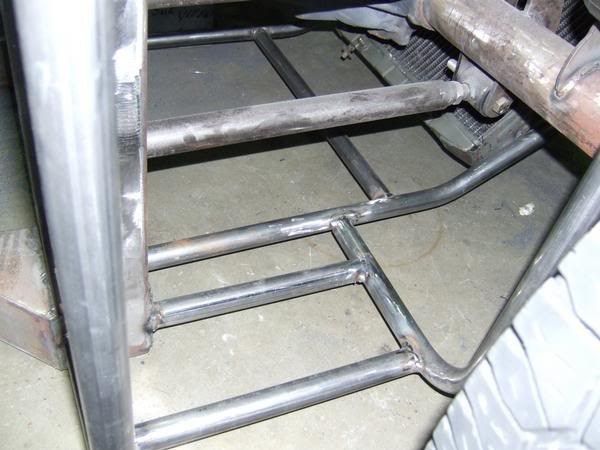

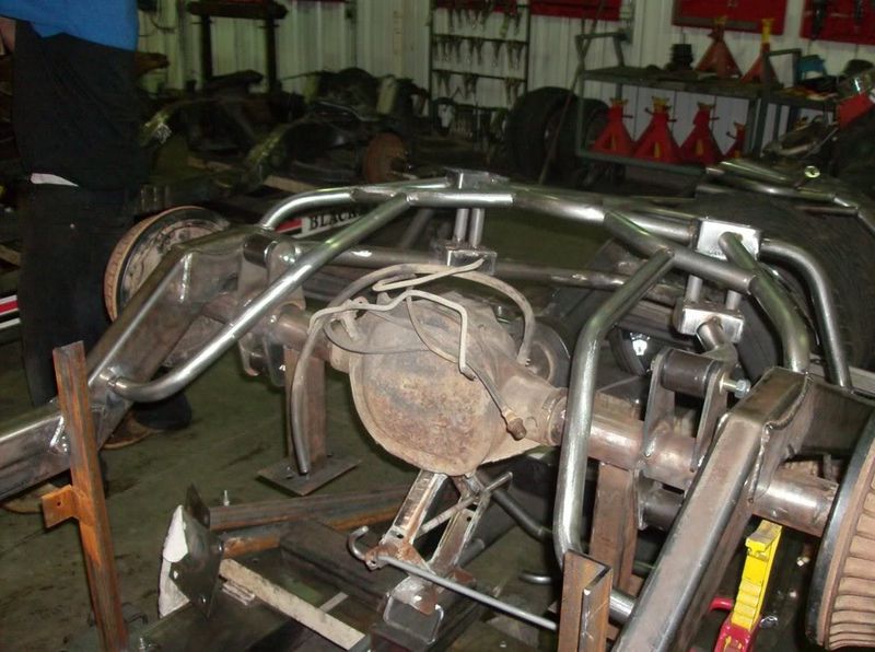

Not sure what to think about the single shear mounts on the frame end of the 4-link. The rear panhard bar looks very beefy but the front panhard doesn't look that way. Other than that, its not my thing but good job.
unusualfabrication's avatar
unusualfabrication
Almost forgot, the frame needs to be capped under the 4-link bars. Maybe its not finished yet or you are planning on running something else though there.

its been chopped and some other work

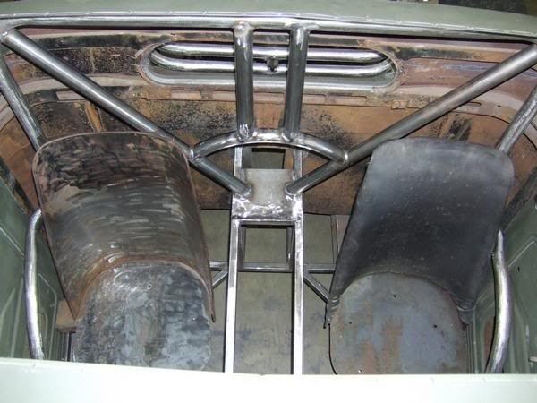

the first pic another truck i was working on sorry
