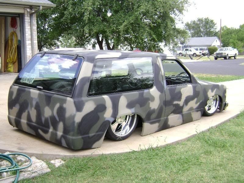

NOT SURE HOW TO POST PICS BUT MINES DOORED

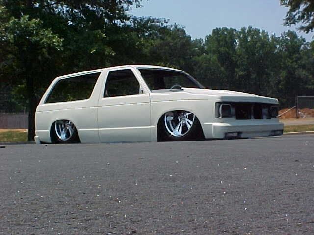

body dropped 6 3/4"

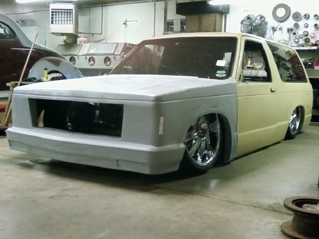

mreed

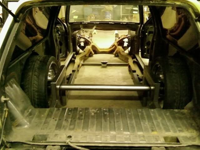

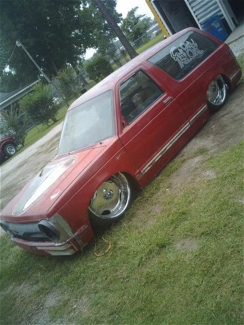

Mine is traditional body dropped around 3 3/4". It lays rocker (no pinch) on 22's. I used an S10 truck frame, shortened the wheel base and made new body mounts for the body of the Blazer.
The door & the front end are just sitting there so my body line is all jacked...please be kind. I've been working on it alot lately and it seems that every night when I leave the shop it looks exactly the same.

^^looks good
is the hood welded shut?
mreed
It's a one piece clip. I'm not 100% sure I'll be using it. I like it because it cleans up the bumper area & all that...but it fits like crap right now.
