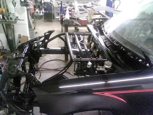

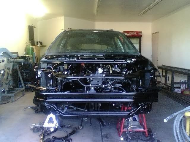

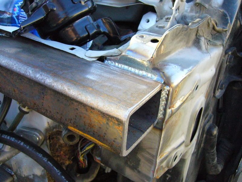

late night body work hours before the show
Got Lift
FREAKS!
Driving home.. 5.0 right next to us

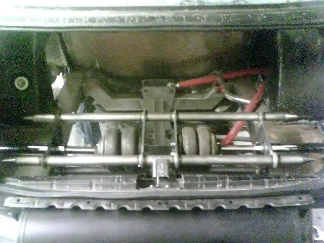

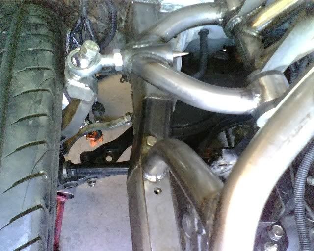

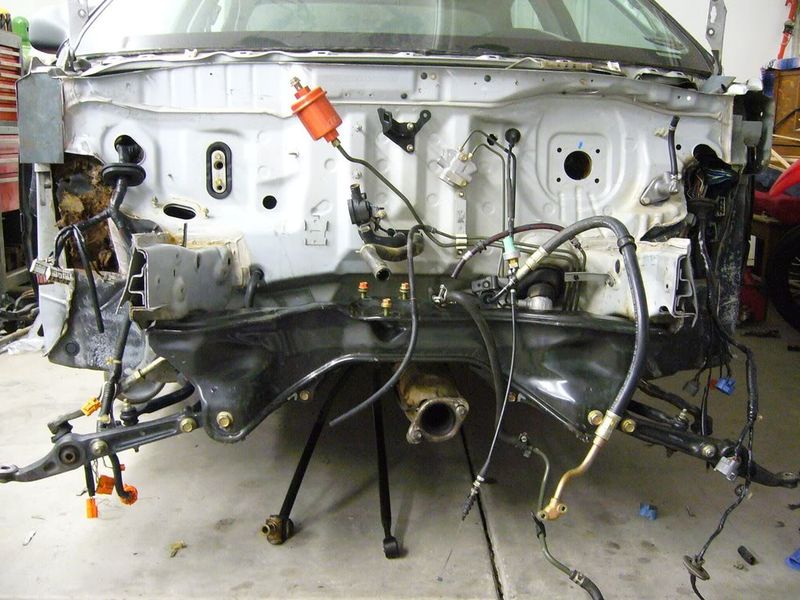

What size cylinder is up front?

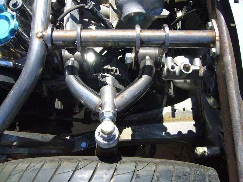

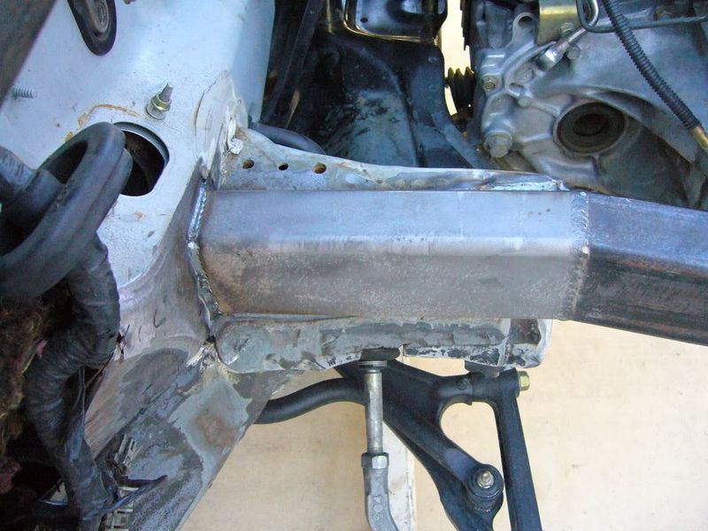

F'n beautiful work. Inspirational. I have a new target for the front suspension design on my VW.

Your car is amazing - hands down respectable, amazing fab work. The only thing is... I've done that bags with juice thing and it sucks balls. The guy switched over to juice since it was so bad.
1) The cylinders weren't really breaking in. You need real worn in cylinders for it to work right. 2) As soon as some oil leaks out which with the cylinder the movement as some squeegees out which is normal, it loses pressurization real quick 3) How do you plan on pressurizing it? The only way I was able to was with a remote hydraulic pump pushing pressure into it along with ball valves to trap it in
I have a good friend that had a hydro air setup on his car about 10 years ago and he had the same problem. After awhile the fluid leaks out and you start to lose lift. Then one of us guys with hydrualics would have to connect a line to his cylinders and fill them up again.

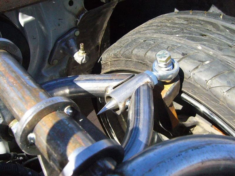

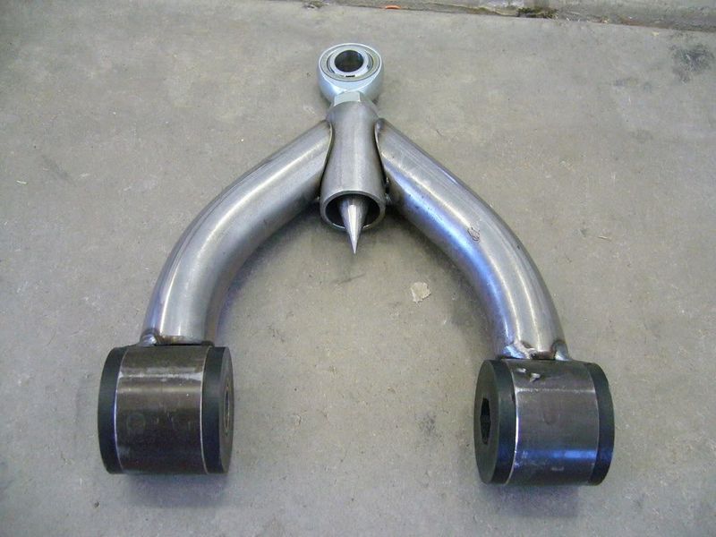

Any pics of the spindle/knuckle for the rear setup?
