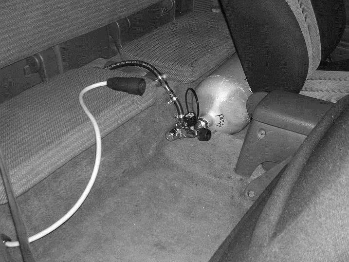

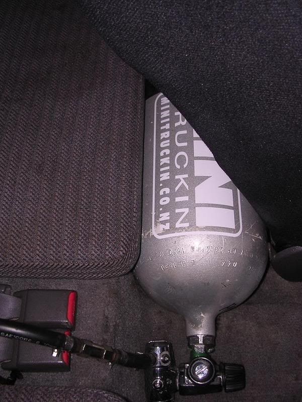

A dive bottle/scuba tank set up!
It has saved me once when the truck was laid out, and the compressor relay failed
Also great for switch play & hopping = Instant air
