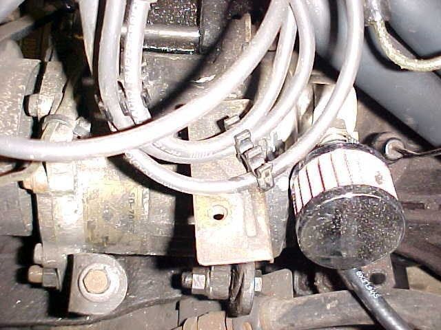

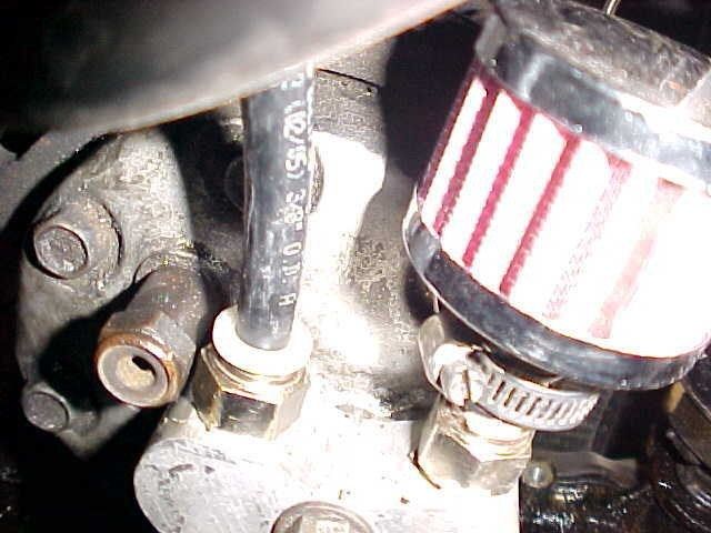

Here are a few pics of mine, i know they are not great. But if you need more info and all just ask.
Basically what i did was remove the old fittings for the A/C and tip the compressor for 3/8 NPT. I myself just inserted some push to connect fitting to the compressor. Some people say to use a leader hose due to heat. But i have had this setup for 2 years now and no problems. I do recomend adding a check valve on the supply line due to the compressor not holding 100+ PSI. So the check valve keeps it alive basically. Also i check my oil one a month...or so, i'm lazy and have went 4 months with no problems. I wired the pressure switch one wire to the old wires for the clutch on the compressor. And just gave the other 12V.

I dont belive so, I belive that all chevy factory pumps are freon oiled. The Mazda pumps have an oil sump from the factory so there is no need for oiling through the intake line.
