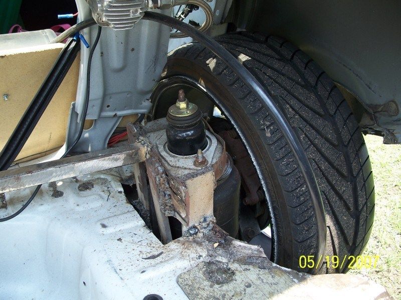

I'm less concerned with overbuilt stuff with no crumple zones slamming into me, and more concerned with cobbled together shit boxes rolling down the freeway next to my family. Getting rear-ended, or taco'd at an intersecion...that happens, I'd consider those accidents. Twists of fate, hapenstance, reletively unavoidable. A booger welded revese 2-link failing at 65 mph on the freeway, slamming a "built not bought" mini into my my wife and kids....that's where my concern lies. Guys draggin there trucks into burning piles of rubble on the interstate, endangering not only themselves, but others...that bothers me. Those are the kinds of things that are gonna get our hobby in trouble, not the occasional fenderbender with a soccer mom's Expedition.
Please don't get me wrong. I drag my ride every now and then, and am all for doing your own work...but common sense has to enter somplace. I mean really, why would you build or drive something like this
Even the untrained eye can see that's not right, but it's still on the road...
And really, if your gas tank is as low or lower than your frame rails, dont lay your truck out at 60 and just kinda hope for the best...
