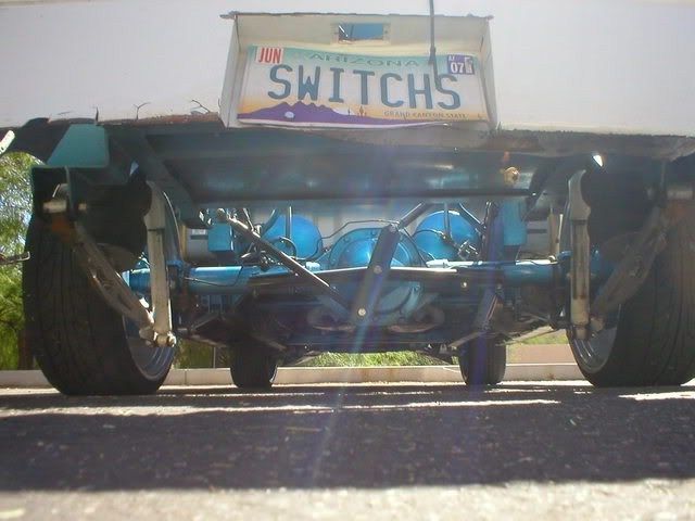

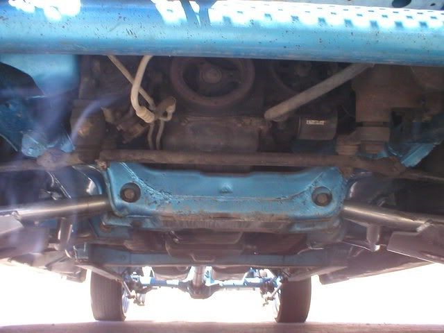

That looks cool.Do you have one right under the cab where the framerails are.you know normally all the lines run on the frame under the cab all the way to the back.

damn mike how often do you drag your truck?
FluffyFreak's avatar
FluffyFreak
that Watts Link i sexy sexy mike

run everything along the frame rails so its not on the ground, kind of like factory...

soory to jack but what is a watt's link really for?
jerid's avatar
jerid
^--a watts link is like having a panhard bar but from both directions without fighting each other. It helps keep the axle centered when you have a parallel or a 2 link

I pretty much figured to run along the frame, I just wanted to pics for what a clean set-up would look like.
