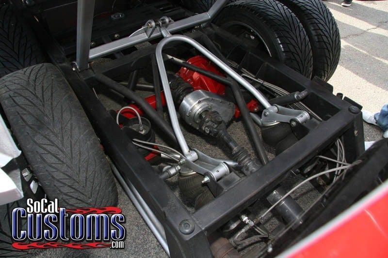

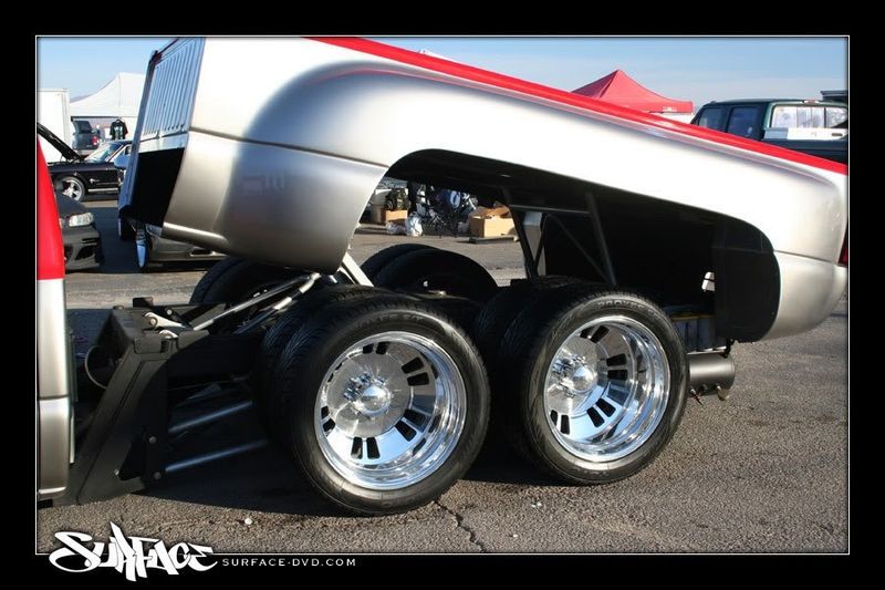

ChassisByAaronIha
Truck runs, drives and TOWS perfectly. 2 Parallel four links with diagnal panhard bar. Bags on top of both axles. As far as the air system, Both axles are tied together but each bag runs its own separate valve to rid of sway. Driveshafts must run cv's (telescoping) so they do not bind on eachother or the rear ends. I can supply you the transfer case we used.

fatboysS1O's avatar
fatboysS1O
yep, i knew it. thats the pic i saw of the parallels. i knew i wasnt a tard.
