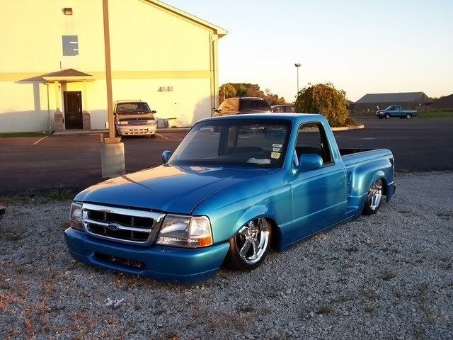

Ok with gas prices getting so out ragest, and being a poor b*stard lol ive decided to get rid of my hoe and pull out my mini again. Is there anyone out there who drives there bagged ranger daily? what about bagged and bd ranger daily? I was thinking about going ahead and putting a toyota front clip under my ranger, cause i want to help the camber issue.......anyone out there?>

just wondering what kind of problems they might encounter....i had a s10 bagged on 17s i drove daily in highschool, and a 92 1500 on 22's that i drove daily too. Well the ranger aint got no heat and a/c, but when i was driving it daily i like to ride so low that i wore the front inner tires out in about 2 months, or 3000 miles. i am abuout to finally get it z'd, which i know will help a little bit, ive been looking into control arms, but no1 makes a set yet unless the custom make them. whats the best way to help fix the front end problem, i just want to be able to roll low in my ranger i like i planned on doing when i bagged it. tires aint cheap anymore, along with gas, also does any1 have any pics of different ranger bed covers for a fleetside? and possibly pics of your wiring harness relocated?
