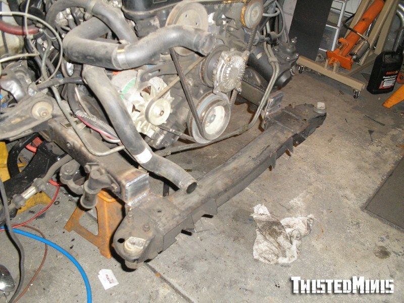

Ok. I know you did a write up on this on a few sites seth. but do you or does anyone have pics that shows the frame horn and the front of the body during a body drop
TwistedMinis's avatar
TwistedMinis
