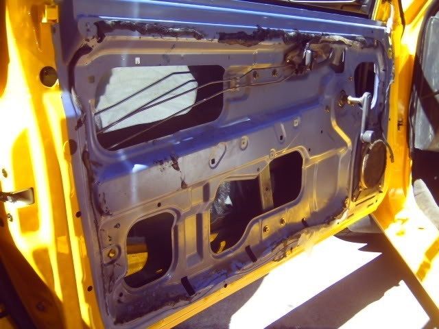

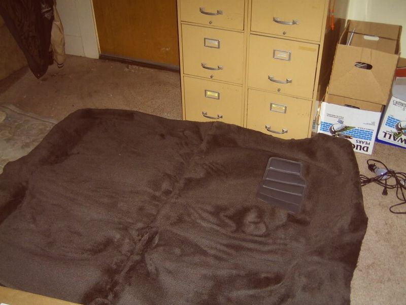

painted the trunk, just a quicky before i dynamat and put the stock carpeted paneling back in

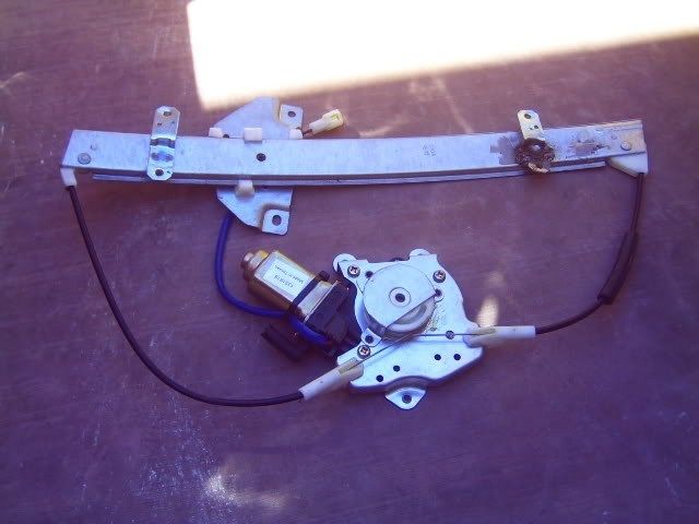

manual windows
power window regulator
the 2doors didnt come with power windows, only the 4doors, but this is a regulator off the next generation mitsubishi mirage. I cut and moved and welded the bracket and it bolted right in!
