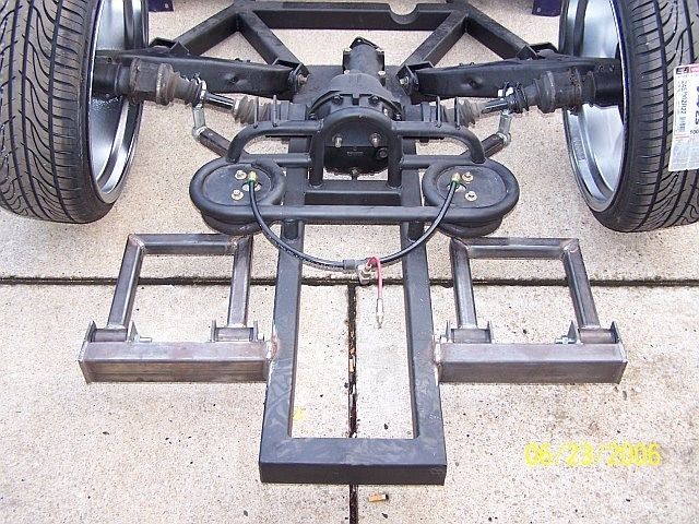

I have the same 300zx rearend as Trace does, theres pics in my profile of it( would post pics but im at work). The mid 90's 300zx has knuckles and controls arms. I have one out of a 92 300zx for sale if your interested, just IM me.
fatboysS1O's avatar
fatboysS1O
Jason's setup.
