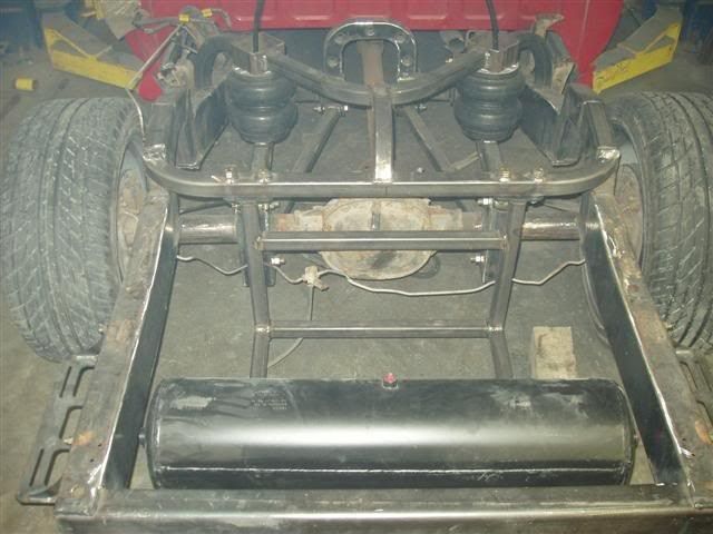

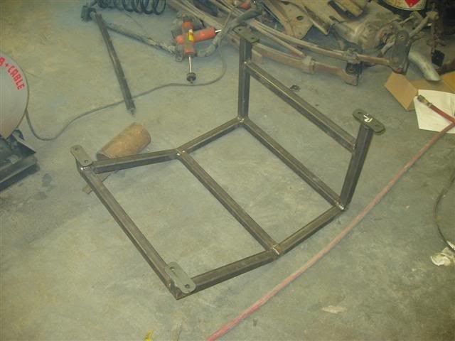

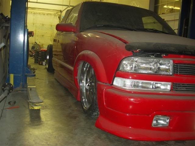

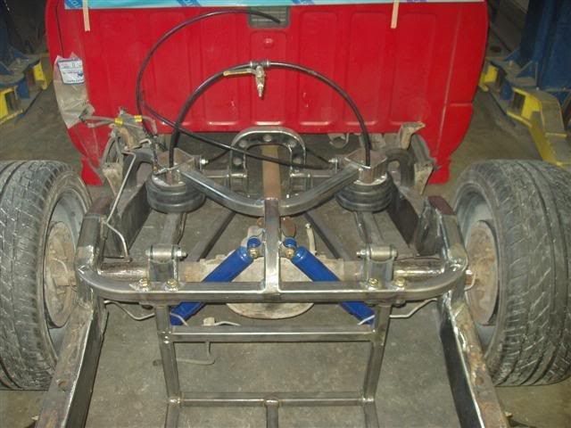

Just figured I'd post up some pics of an Xtreme that I'm working on right now.
Plan is for an open bedfloor so he wanted something a little different than all the other s10s in the city. Rails will be fully boxed with 1/8 plate. Bags on the uppers. Custom fuel cell and the 7 gallon tank.

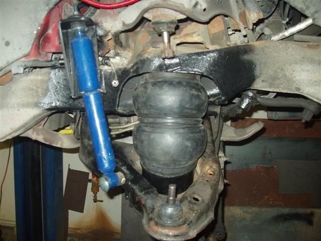

Building the lower link bars:

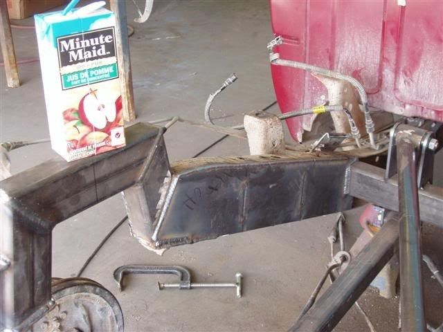

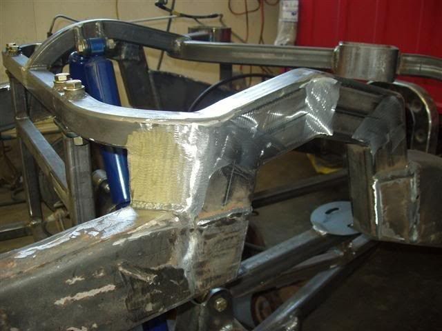

Building Notches:

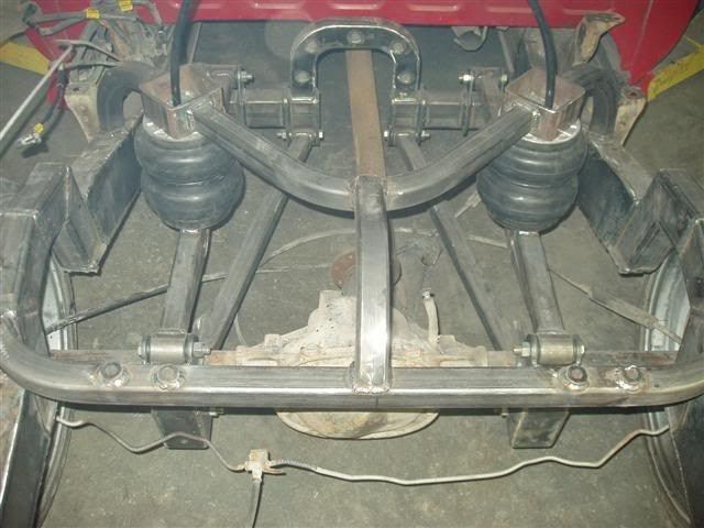

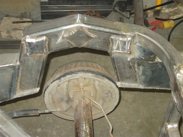

Building crossmember and mocking up link setup:

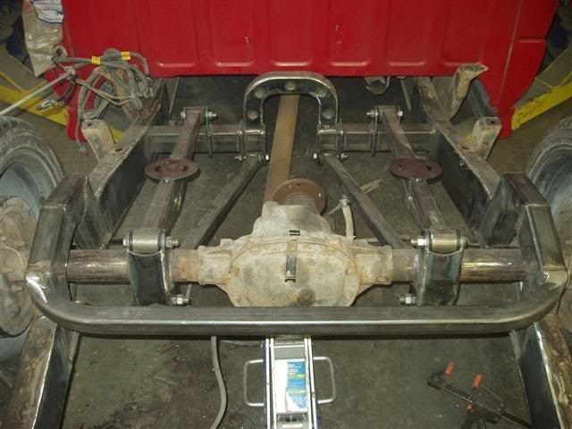

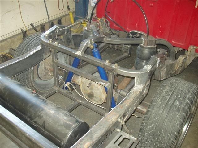

Where its at right now:
I'm waiting on tubing for the bag mounts so I'm just gonna work on the front today. I'll update again once some more work on the rear is done since theres nothing exciting about the front of an s10.

Nice work once again. Clean welds.

propel? wheres the minute maid fourties!!
impulse's avatar
impulse
I figure i'll post the latest pics for him...
bdroppeddak's avatar
bdroppeddak
ahh there it is, i must have missed it the first go around!
