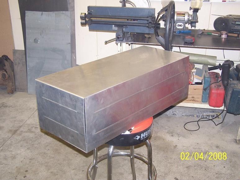

Thought I would throw up some updated pics of the fuel cell. I have all the beads rolled into it, 2 on each side, and 2 on the dividers inside the cell. Just have to tig it all up and pressure test it.

That looks awesome.I like the way it fits up too, with the radiused edges.
What are you using to make those brakes? And what thickness is the aluminum?

We have a large electric/hydraulic brake at work, if you get it just right you can get a nice radius instead of a sharp edge. Only thing that sucks is that it leaves some fine scratches on the sides. You can see them in the second pic just above my seat. Thats one of the reasons I want to build a brake, so I dont have to polish those scratches out. Its 16 ga. aluminum.
