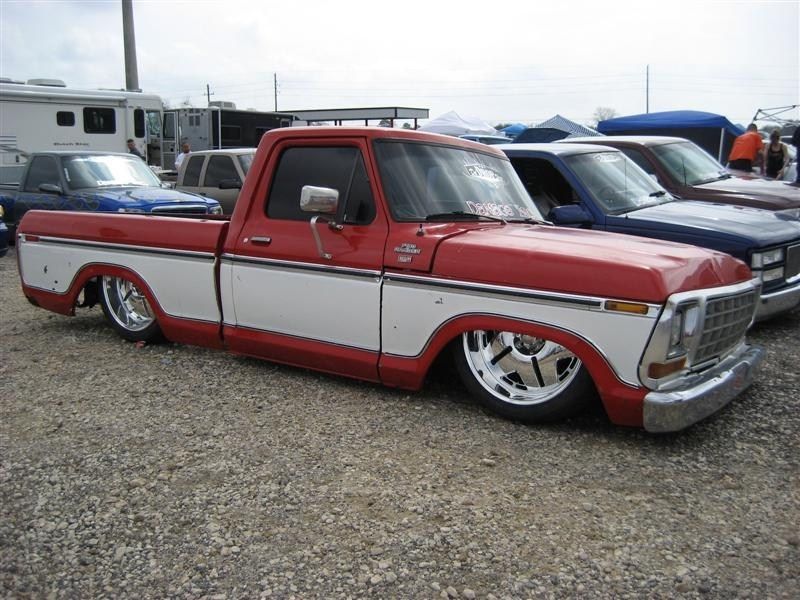

This truck has a telescoping wishbone on it. Maybe you can check with the owner to get some details on it. I saw the truck at Heatwave and remember discussing the wishbone with a friend.
I know a guy who builds drag cars and he puts a telescoping wishbone on all of them. He uses no bearing, it's just metal to metal. Yet on a drag car that's not a big deal. Specially one that makes 65 passes a year and then is totally rebuilt during the offseason like most of the ones he builds. I'm sure you could find some typed of bearing to work. I say why not just use a watts link. Tried and true, and takes up less space.
