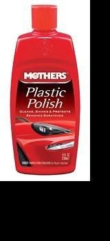

Whether it's your turn signal lenses, center caps, brake lights, convertible top window or the clear plastic gauge cluster cover, Mothers
