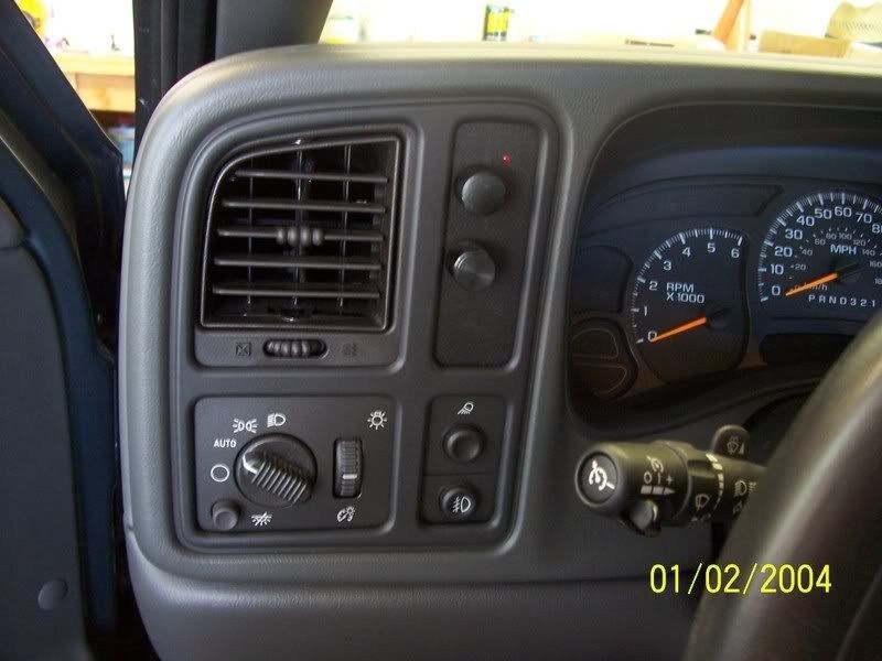

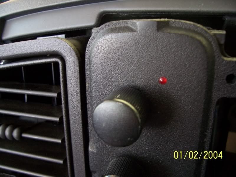

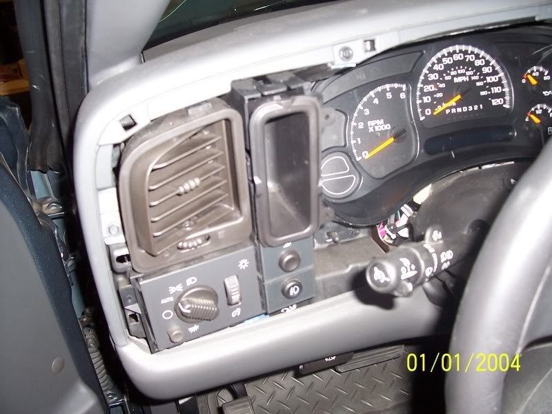

any automotive paint store the carries the SEM line. also in some caes you may need to sand the texture after. I usualy spray it with an SEM color after. For blacks their Landau Black has just the right shine to it.Here is one I did.
it was an empty area in a Chevy dash------
now - compair the texture to the stock AC vent texture
Damn that looks good, going to have to get me some of this paint
