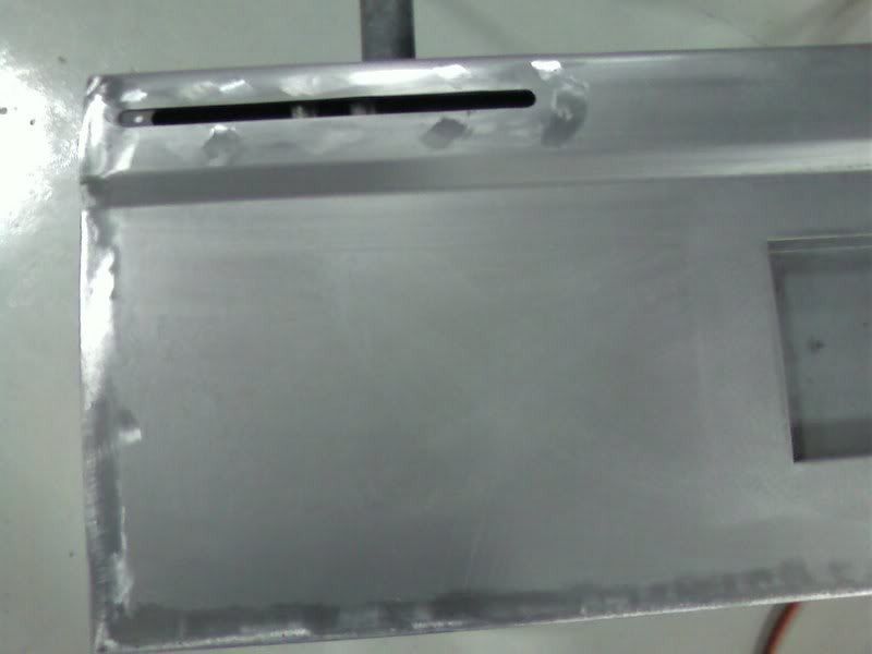

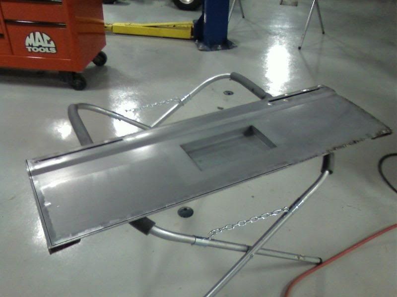

Well if its a grant skin you better not take the whole factory skin off. grant skins aren't made to hammer a dolly back on like most of your door skins. i have always left about 1/2 inch of factory skin all the way around the tail gate then put the new on and weld it back together all the way around. if done correctly all you gaps stay the same and you wont even need body filler.
treylos's avatar
treylos
Edited: 10/6/2007 11:36:28 AM by treylos
Maybe this will give you a better idea of what im talking about.

I get what your sayin. The one i got is a FBI skin. It gets dollyed on the bottem and im guessing welded at the top. I gotta make pieces for the side to make up for the dip that in the middle of the factory skin.
