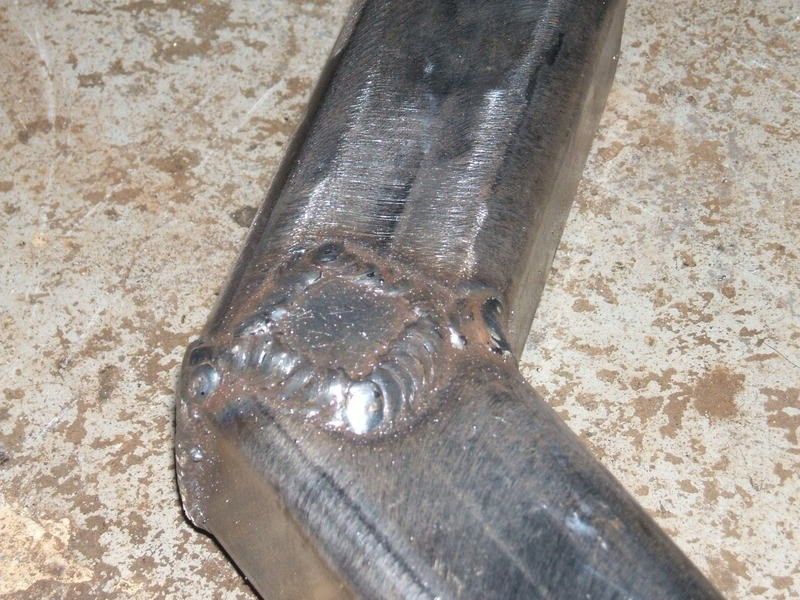

I prefer homemade 3 piece notch's personally, saves time, material and money. Cut your desired notch size on 35* angles using your desired size box tubing in 3/16(.187) weld them together. Mark the center of the top of the notch and line it up with the center of the rear end. cut into the frame and slide it in. Weld it. Cut out the stock frame section. Box in the the sides and front and rear of notch with plate steel.

I can always rely on minitruckers to overkill the shit out of everything...very true...I did a little over kill on this....2x2 .250 box tube with the joint braced with .125 plate....good point on the bars max, that is why you have your own section :BOWDOWN:
