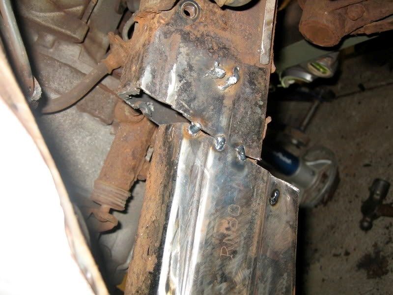

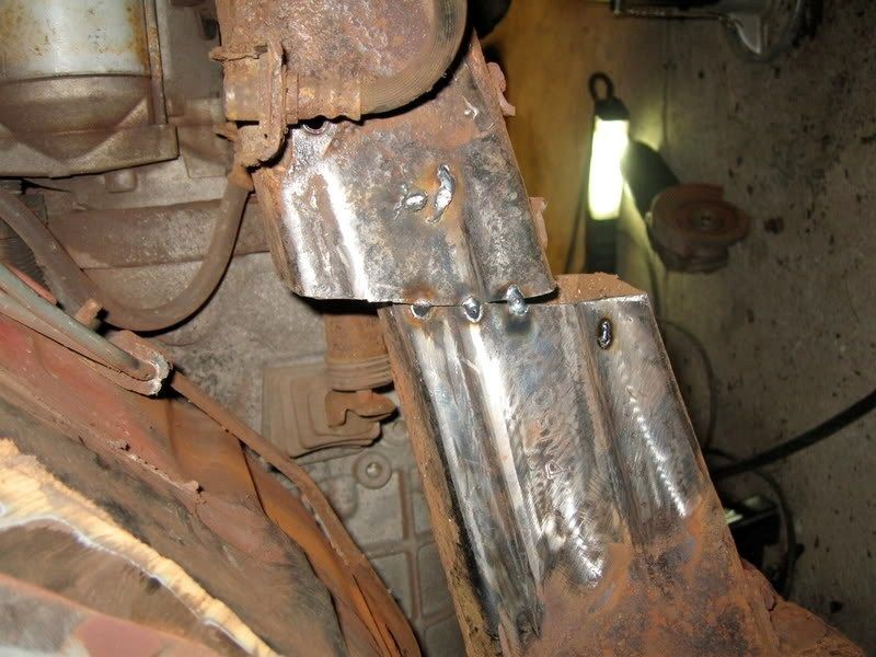

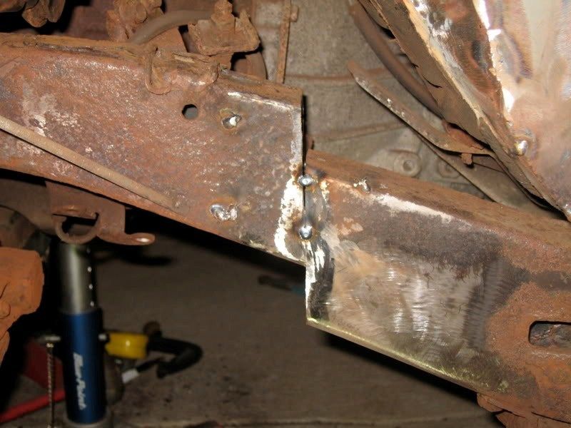

ok i grew some balls and just did it here is some pics[

any one see any thing that looks off or suggeststions hey MAX u got anything

Looks like you did it right. Just make some transitions in the shape of a triangle to support it, weld them and the sides up, then plate over it.
