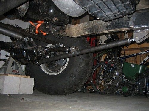

Well this is the Ask Max section. I assumed you just wanted his answer by putting it here. But if you really want everyones opinion, I think a ladder bar will work exactly like a 2-link.
But you could run something like this, which would essentially be and adjustable 2-link that will articulate some.This setup needs a bushing mount at the frame, and the rest to be heims.
However I don't really see a good reason to use something like this on a truck when a parallel 4-link would fit in the same location and ultimately work better.
