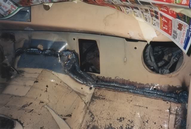

3.5 should be even w/ the frame. cut outside the body mounts or it wont work, and angle the outer filler plates so the door panels will still work. cut the firewall were the floor is seamed ot the firewall and go right above the tranny tunnel. you will have to shorten your pedals also.

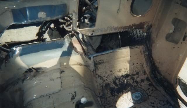

I did have to cut up into the top part of the firewall where it sticks forward to allow the ventilation to the cab. you could see the valve cover through the vents in front of the window. also with 4" i had to cut the shit outta the hood all the way up to the cam gear. but im pretty sure its the same with a stock motor because mine was with the turbo 2.3L

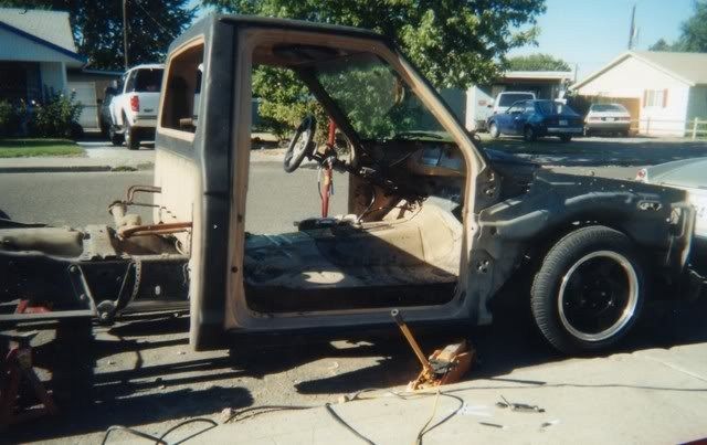

i finally was able to find the pics and scan them. it may be too late now but here they are. i couldnt find them all but i hope this still helps. the top part i cut was for clearance. the back of the valve cover would hit. do you have all the sensors that come on the motor. its a pretty easy swap to do but mine was a little more difficult because someone cut the wires off on the harness and i was also goin from carbed.
