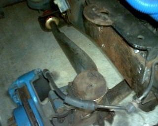

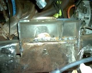

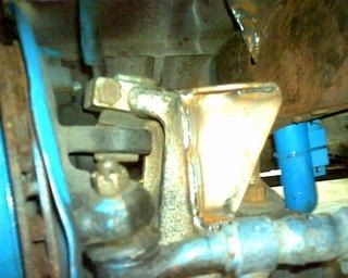

This is my setup. It might help you out.

About time i learned how to post pics huh.

do i have to notch the frame for my tierods no matter what size rims i run?
mindlissmetalfab's avatar
mindlissmetalfab
yeah on a ranger they will pretty much rub with a 3/4 drop if you have the sleeve bolts facing up haha.
ED
exotic dreams
You mainly notch the outside frame about 3 inches and the inside of the frame about an inch. Just be sure to brace it good. It's on the right side of the pic.
