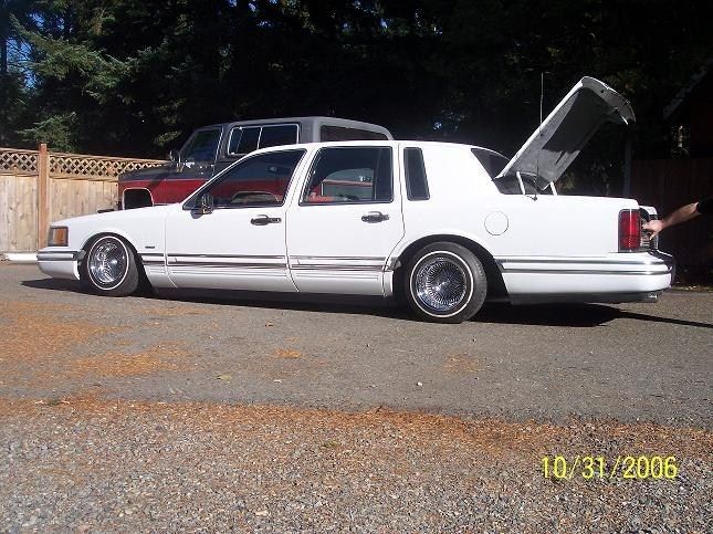

u can keep the stock bags in the back they hold up good. all u have to do is pull the valve off the bag & tap it for a fitting...the back will b about 1" to 2" from the ground....take a look in my profile at my old town car thats how low it will get

is this all the way down and if so if i put some slams back there would it get lower

the frame is on the rearend so ur goin to have to notch it
