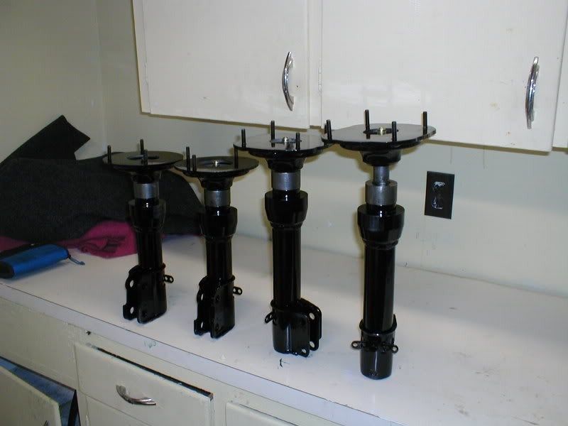

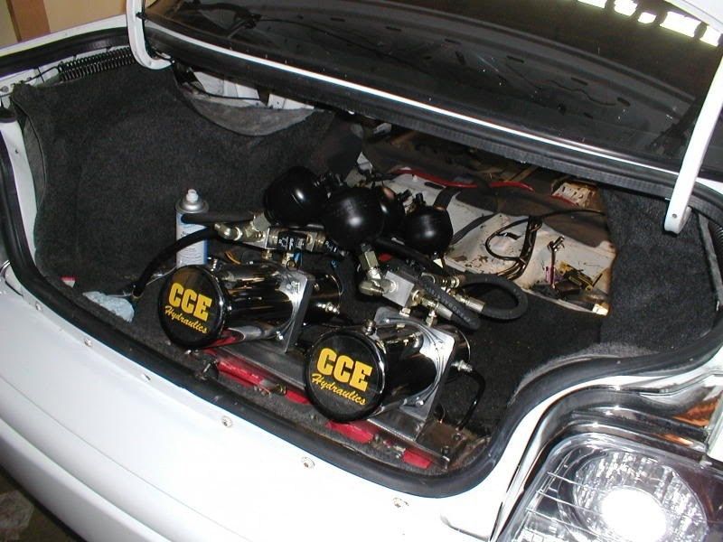

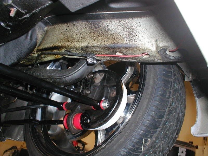

Sweet neon..
do you have any pics of the front and rear setup on it?
i want to put air on my neon soon
