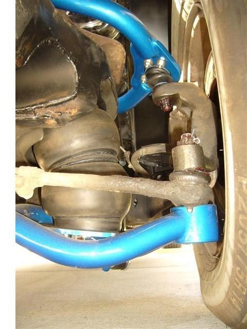

do the SD's or ART arms really allow you lay on 22's? what about drop spindles? still need to run upper or lower bag brackets?
8D
89s dime
those r the SD uppers and lowers. You only run the upper cup. And yes u can lay with dub duesces with SD arms with no cutting. ART arms ur gonna have to notch the frame for the lower arms to come up with 22's. Make sure u notch for your tie rods also like you see in the picture.

oh ya and im running drop spindles and those are slam rs 62 bags

if you dont want to notch for your tie rods, check out barely legal fabracation. they have a set of tie rods that allow you to run 22s with out notching

i got the SD arms on mine and i am more leaning to say that they can on 22's with the pinch weld mine is to the rockers and well tha measurements look like it wont without sticking through the hood ,, nyce 205/14 lol i have 195/75 on mine. bascially they do but,,,,,,they dont state with or without the pinch

You beat me to it, I was gonna say the same thing. Get with Taylor (Chopped Mazda) on here and he can square you away with the notchless tie rod end kit.

what about the silver star customs arms? only 525 for the set
