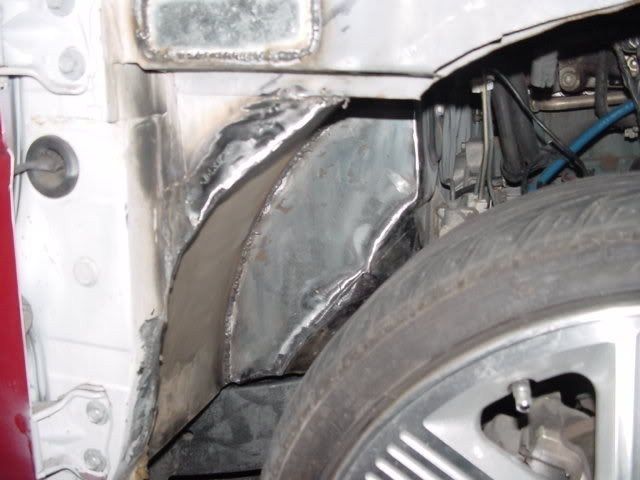

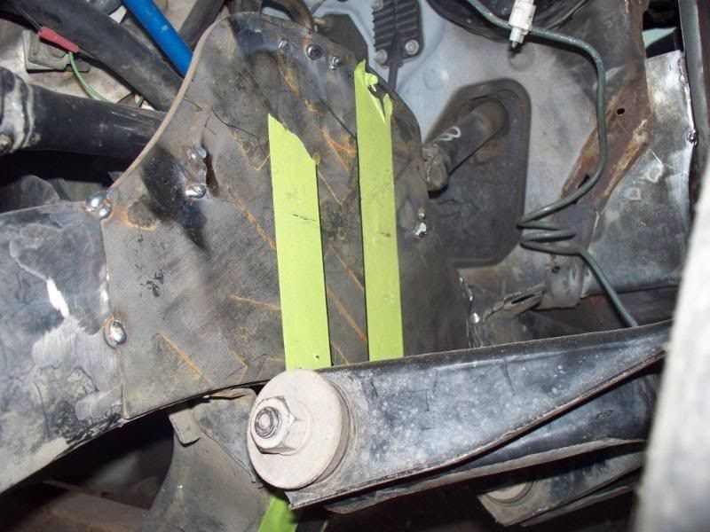

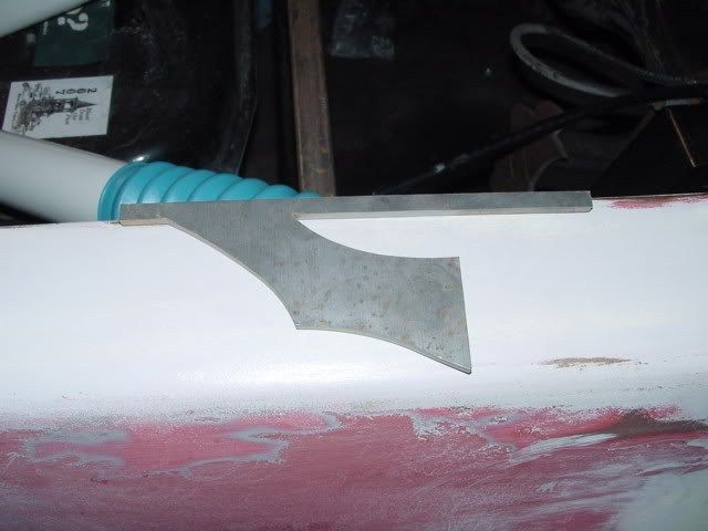

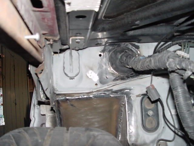

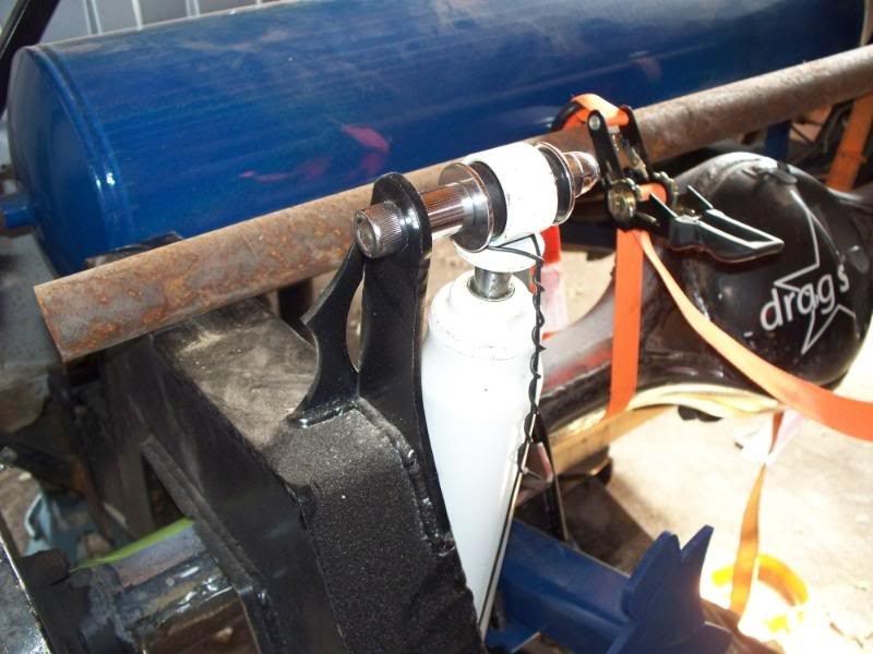

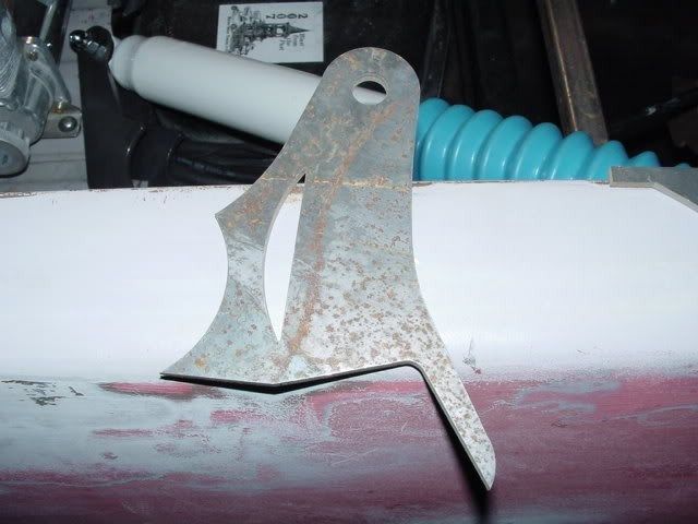

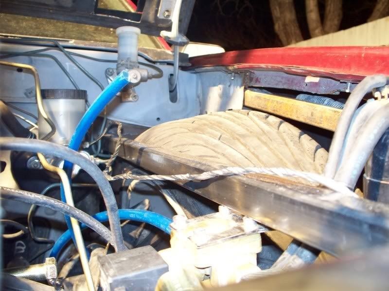

now that's some camber i can live with for now    -7 degrees dropped and -1 degree lifted don't have the travel id like but that's later on this is on stock spindles and stock uppers modified can-do lowers he took out the ball joint angle for more travel with less camber   the upper mounts were moved  3.55" up and castered back 5 degrees
xefchopper's avatar
xefchopper

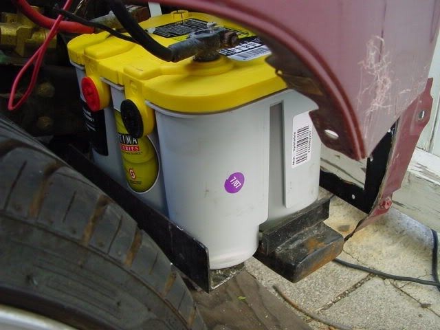

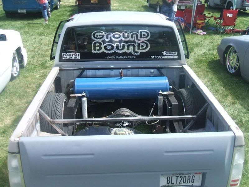

I'm likin the build, but is that it for your bag mounts in the front? Those two pieces of 1/4" plate? I'm alittle worried about that holding up.
smithchassis's avatar
smithchassis
i wouldnt worry about the camber as much as I would that upper mount breaking in about 5 seconds, from the lack of gussets to the non penetrating flux core weld its a big recipe for failure.
