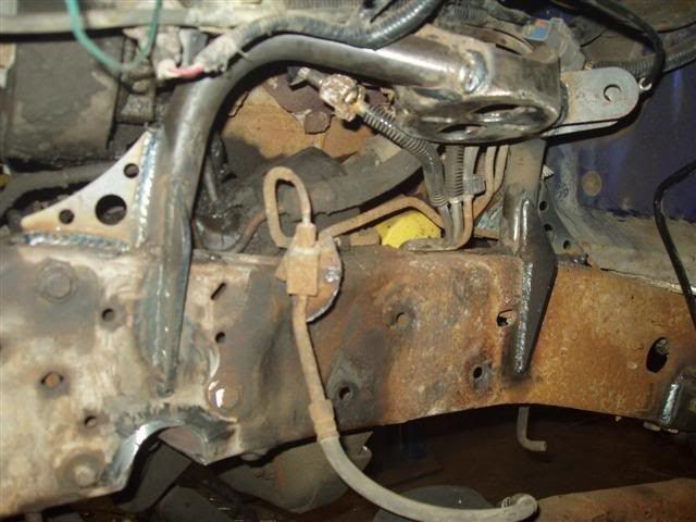

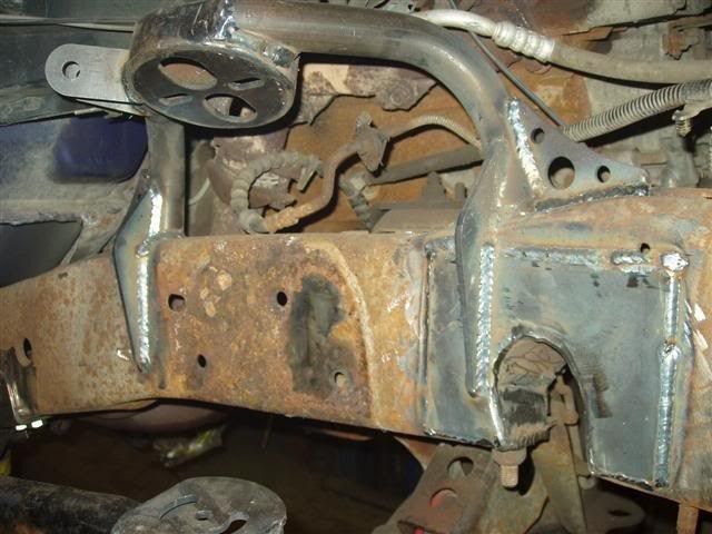

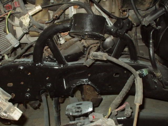

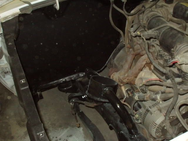

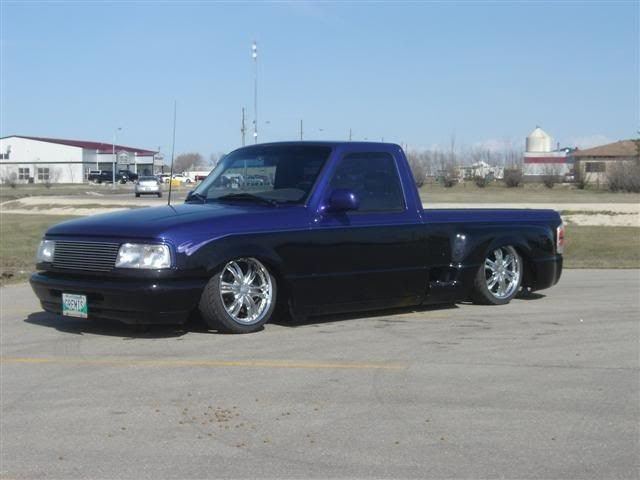

does anyone have any pics of the front of a bagged ibeam ranger too help me

Look at crazytalkcustoms and look at shays ranger. ALso check out www.houseofkohler. I am doin the tubular mounts, should have them done in a coupl of weeks. JIMMY

On 20s:
ON 17s:

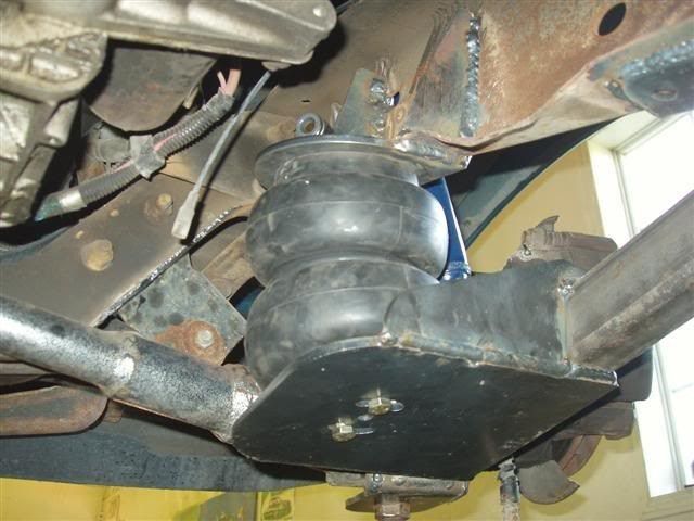

Rad arm setup that I'm working on now...

yes they do lol.corey how much lift that rad set up get?

i'm not corey and I'm pretty confused as to why EVERYONE calls me that.
Honestly I dont know yet, we havent hooked up the air management yet. It gets about 5" from the shop compressor but he'll be running 200 psi when its all finished. Just waiting on his fuel cell to finish it all off.
-JOEL
