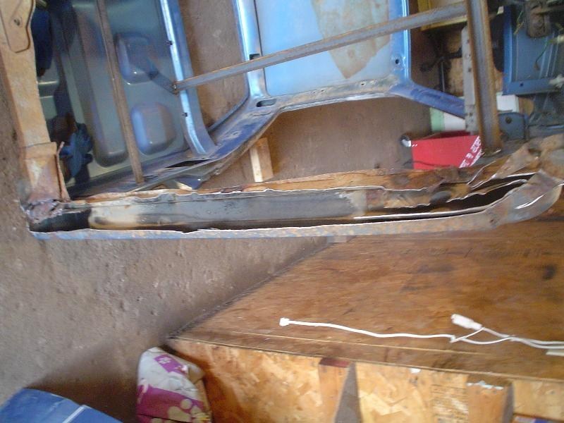

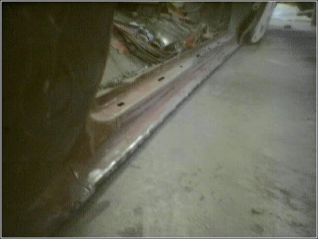

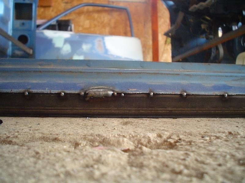

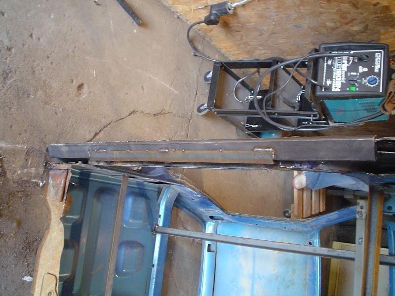

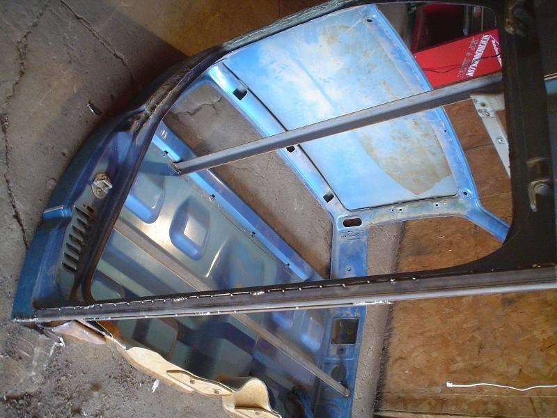

These aren't pictures of mine but some I remember seeing them in a profile:

thanx man that makes it alot eaiser to understand now.
