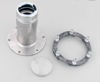

to patch the old hole, id use 2 pieces of sheetmetal and sandwich the plastic together using some sort of sealant and bolts. for the new hole, check out the accessories for fuel cells in Summit, there is a filler neck kit for plastci cells that you could use.
