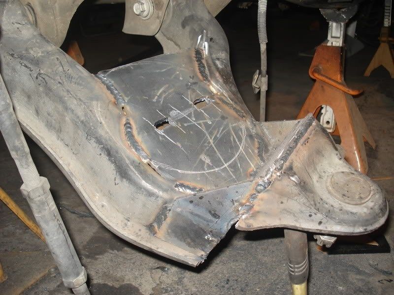

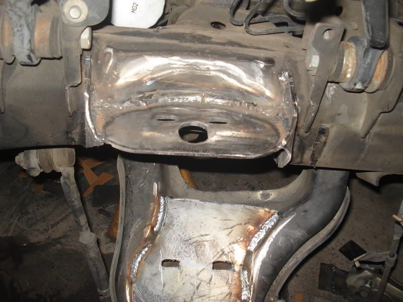

i have steped the lowers and shortened them an inch and layed frame on a 265 35 22. ill post a pic as soon as i can

upper mount(not finished)lower mount not finishedthis does lay on 22's but not anything bigger than a 265 35 22 lower shorted 1 in and steped 3 in and still aligned properly (no drop spindles)
