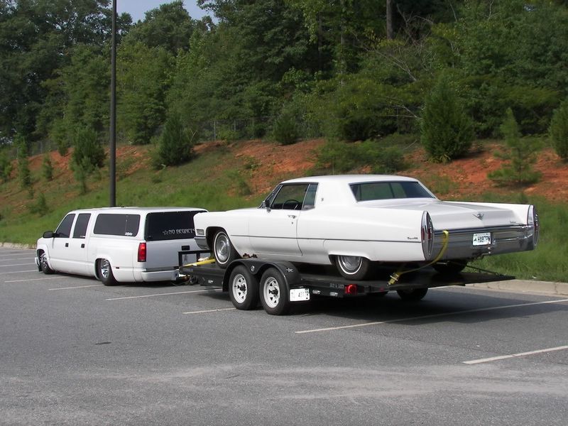

I dont have ladder bars. I have a para 4link from the front with a canti setup from the rear. Very similar to a KP setup for S10's. We just used large bars with thick walls, and under brases on the canti bars. SlamSpecialties 8" bags. I tow all the time with a bumper pull. My trailer weighs about 2400lbs and this Caddi isnt light itself. No problems. Just make sure everything is bracedup good and thick, you should be fine.
NRskinny's avatar
NRskinny
Oh by the way. Sorry for the gigantic wall paper size pic. I guess I should have down sized that pic first.
