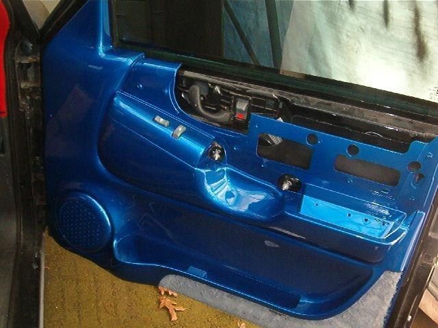

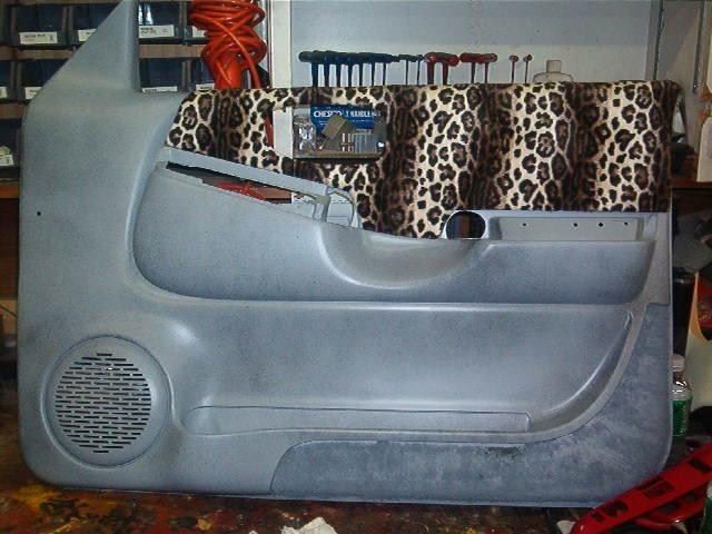

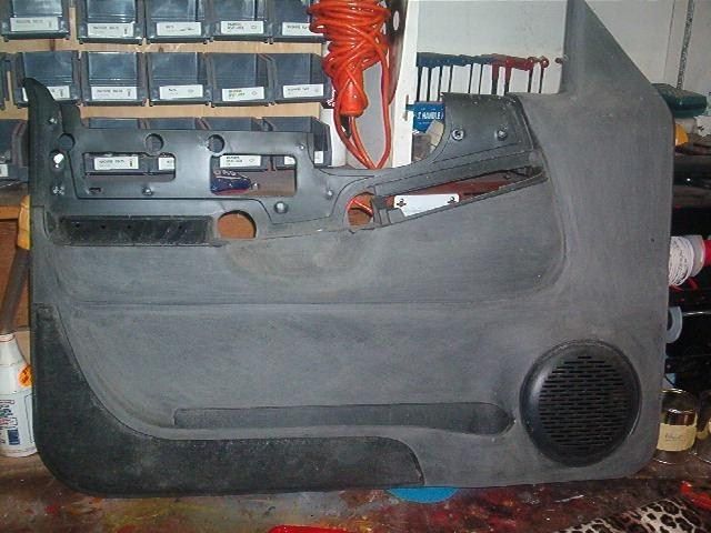

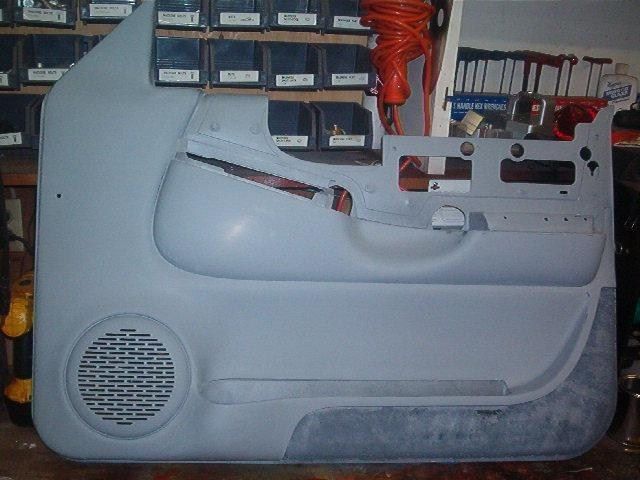

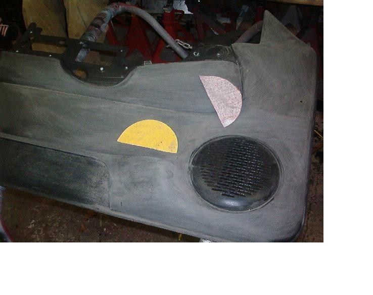

hay i did my door panals so far u need to start with 36 to break down the texture then 80 to smooth out the 36 scratces the ni went over that with 220, after that i primed them with 5 coats of filler primer then wet sanded with 400 till smooth and painted them.
heres some pics.

awesome thats the kinda result i am looking for... Good looking out...
