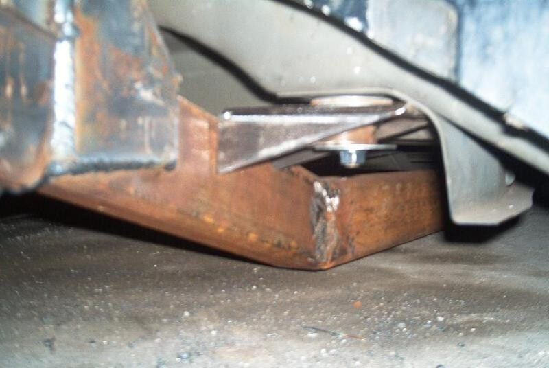

Ok I'm pretty set that I want to make my cab mounts for my truck after I bodydrop it with the 4 Link end bushings turned on there side so that the bolt is going verticle. I just would like to see some pictures of others that have done this. Thanks in advance.

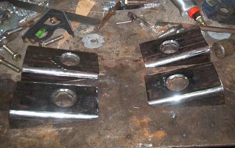

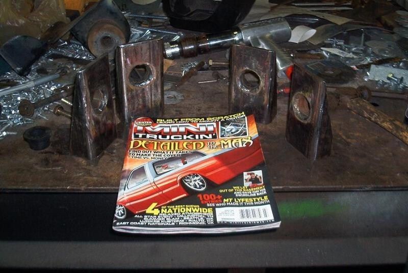

we took pete n jakes bushing endes cut em in half and drilled a hole big enough in the 2x3.
