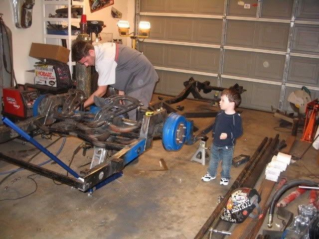

had a helper the other day, he can weld better than fizzle that's for sure

are you just using black iron pipe for all the 'tube' work?
mccustomize
lol yes, I was waiting for someone to say something about it, think it's gonna break?
i cut it's avatar
i cut it
is it schedule 40 tubing?
mccustomize
yes, besides thepipe having a seam and tubing being seamless I don't see a difference, the only real difference is the tolerence to the ID and OD of the pipe vs tubing, would I ever make link bars or unsupported or untriangulated bars out of pipe? No

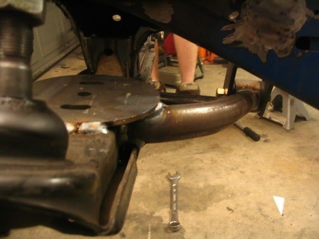

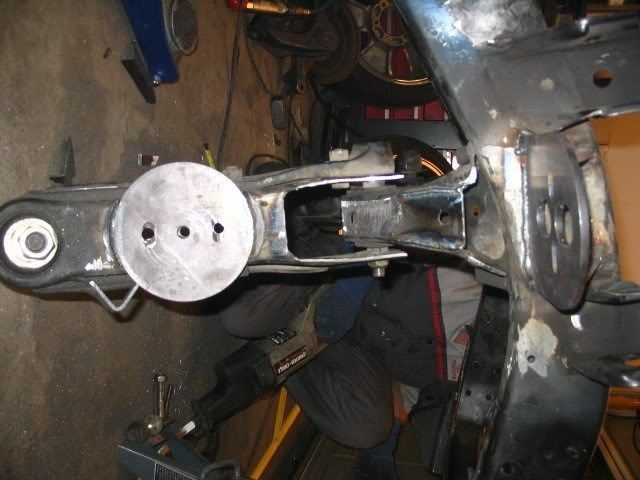

mccustomize

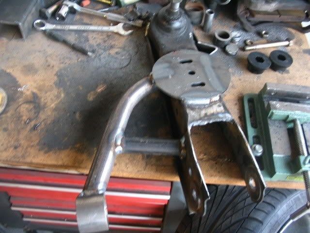

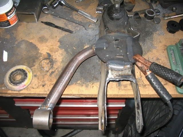

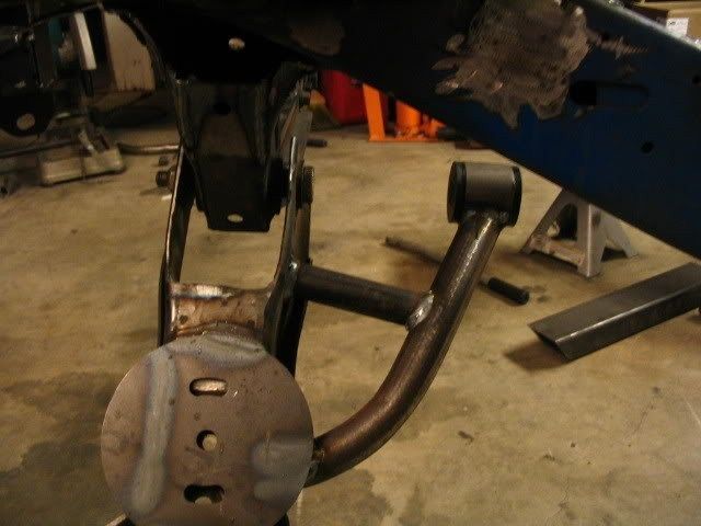

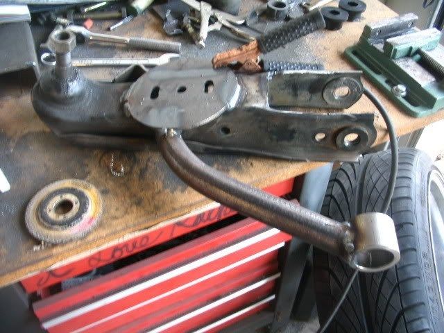

more progress, thanks seth for the info on the lower control arms, they came out great, should be putting the cab on it sometime this week
