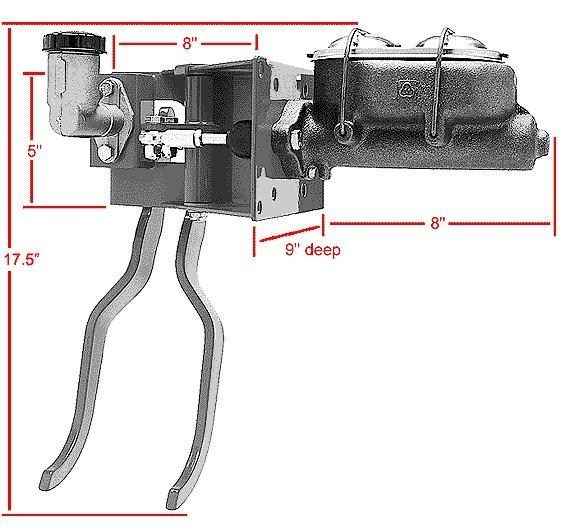

kugel components sells a pedal assembly with a booster and master cylinder mounted under the dash.
they sell it with a booster option too
wilwood sells an underdash assembly also that uses dual master cylinders but no power booster option
