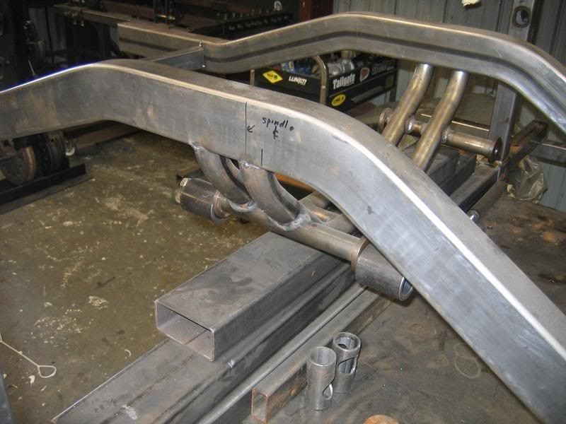

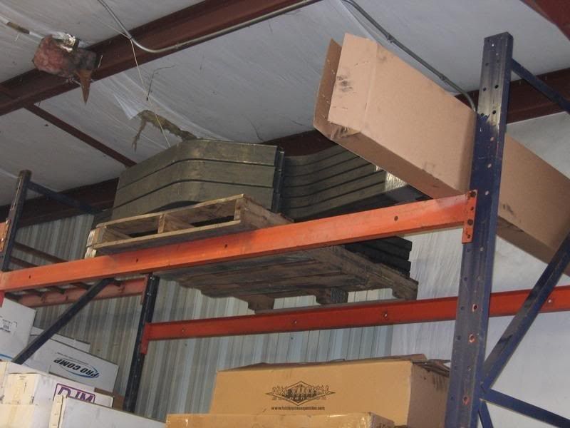

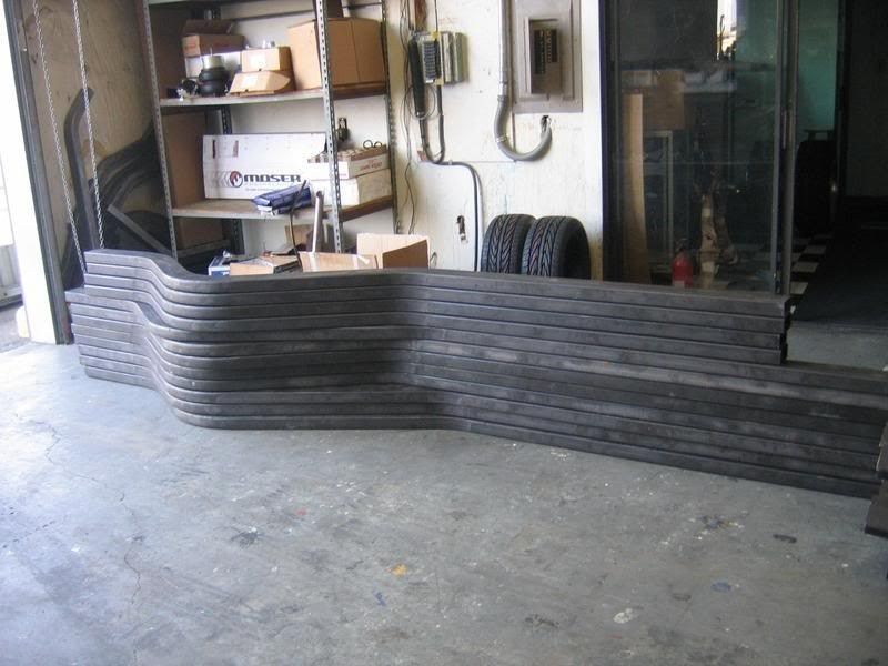

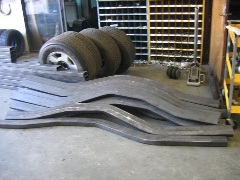

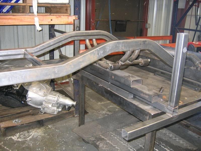

Heres one I've been working on (for long time) no call for it. It is for an S-10 (mustang II/universal style). got rails in stock if anyones interested.

The only thing S-10 about it was going to be the spindles, the only thing M II about was going to be the somewhat "universal" Idea. The arms are about 2 1/2" longer than M II style also.
