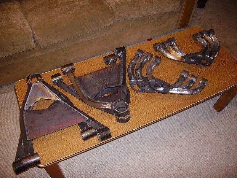

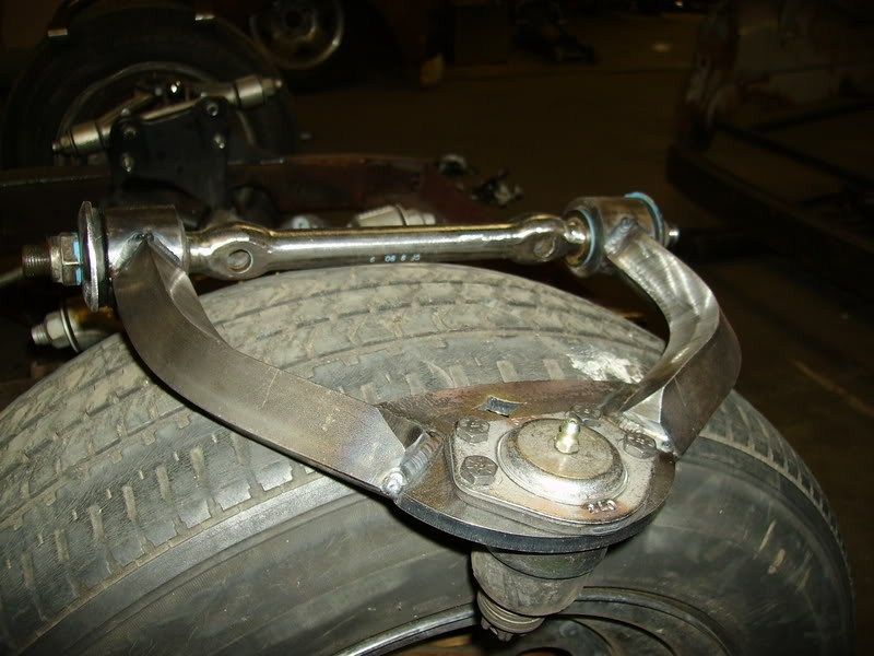

Do you build control arms?
grip's avatar
grip
I build a few minitruck arms and the matching three links.I spent a lot of money load testing square stock and the best is cold rolled 3/4 or one inch.If you have peices shorter than a foot you can use 14 gauge but you can't really bend it without a good bender.
Grip//NC\\OKC
