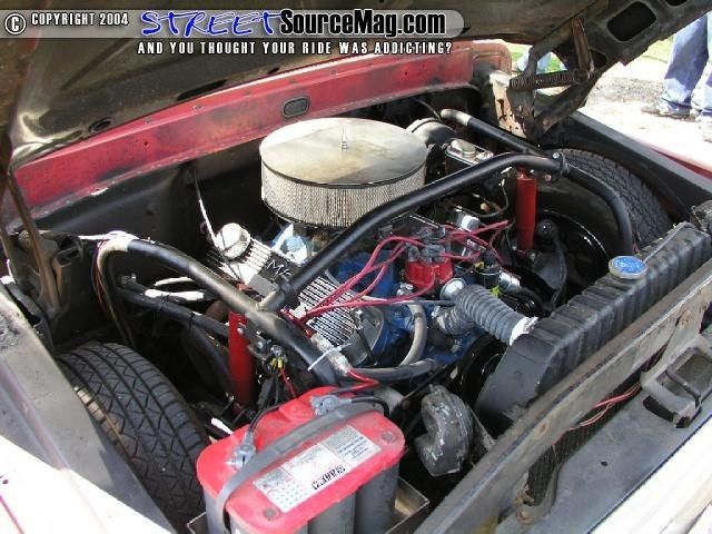

If you have the room, I think the easiest way would be to run a "strut brace" or engine cradle and mount them off of the upper control arm or above the upper arm with a rod coming off to the lower arm.For example, LADAVE's setup on a 71' FordIt's a tight fit.Let me know what you come up with
