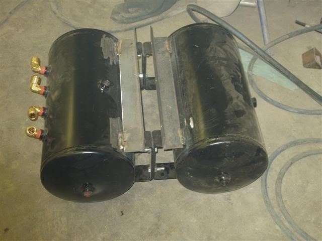

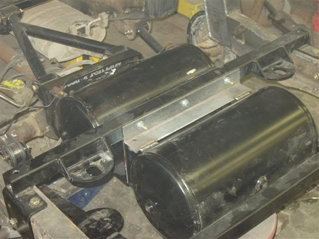

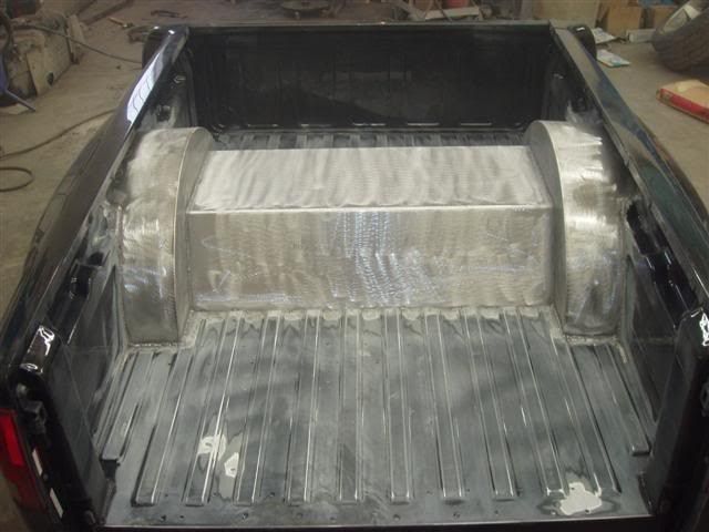

That setup we did that you posted is stock bedfloor above the tanks. The bags have about 1" of clearance from the tanks. he is running RE7s.Its actually a really simple setup...First thing I did was bolt the 2 tanks together at the legs. Then I took 2 pieces of angle iron and spaced them apart the thickness of the crossmember (centered on the legs). I drilled some holes through the crossmember and the angle and bolted it all together.
Then I cut the legs off the rear tank and rotated it to where there was no ports hanging off the bottom and we could run the 4 lines out the back. Then just weld the legs back onto the tank.
Bedfloor:
Hope that helps.
