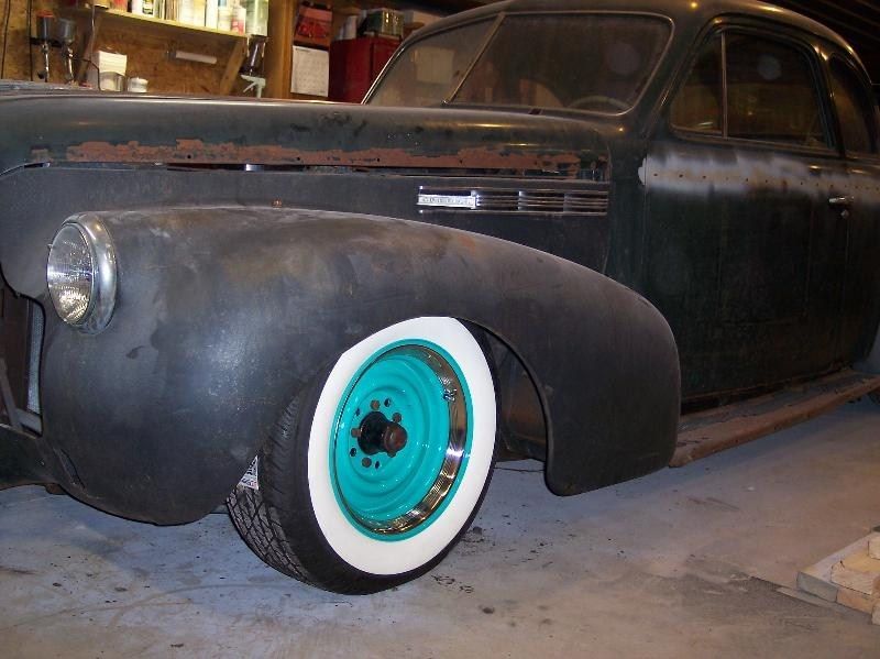

Ok, started looking at the '40 buick I just got trying to figure out what route I'm going with it... the thing is on coil springs all around, so it seems like a no brainer to bag it, but the front A-arms look like there going to hit the frame after only about 4-5" of drop... not nearly enough! anybody know where I could get one off arms made for it? I don't want to cut the originals at all, I want the option of going back to stock on this one...
jmn444's avatar
jmn444
I'd be happy w/ an extra 2" if that helps.... not sure what other option i'd have to keep it fairly stock...

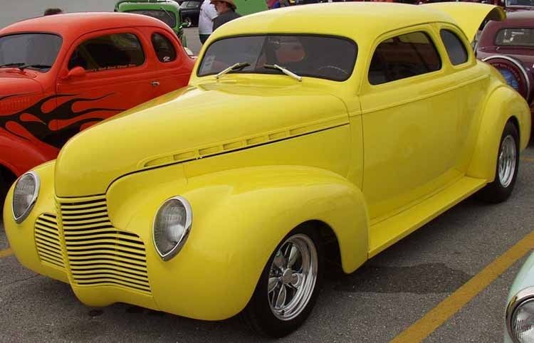

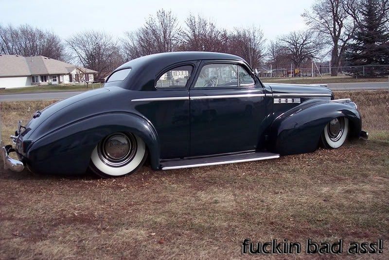

this is what the goal is, but 4-5" only gets me to the top of the whitewall, i'd like it to at least tuck a little...

Dude that car is sick and with that photoshop job you did just adds too it. Def. badass and be sure to keep us updated on that.
jmn444's avatar
jmn444
well, i didn't do the photoshop, so hopefully the guy who did will see the comment... and my car actually looks nothing like that... yet... just got it and it need total restoration, but in about 2 years it should be looking good!
