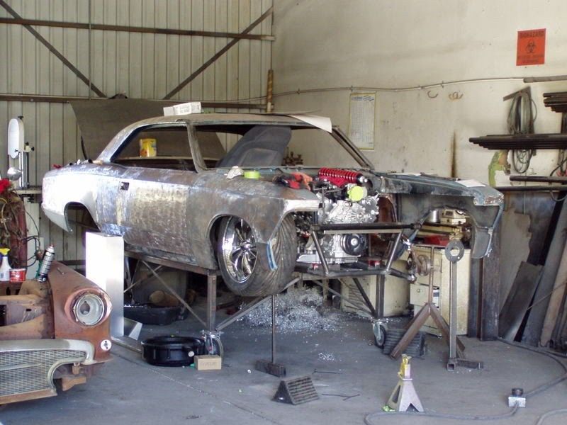

If you look past the crap all over the place you can see the rack that I built for the Chevelle chassis. It really does make things easier. I am stock flooring a Blazer right now and it is on a rack just like that as well as the Mitsu I am building for Ernie. As for the suspension part, draw everything out on the concrete and/or some masking paper sothat you can figure everything in fullsize. Any decent paint supply shop should have 36" wide paper to figure everything out on.
