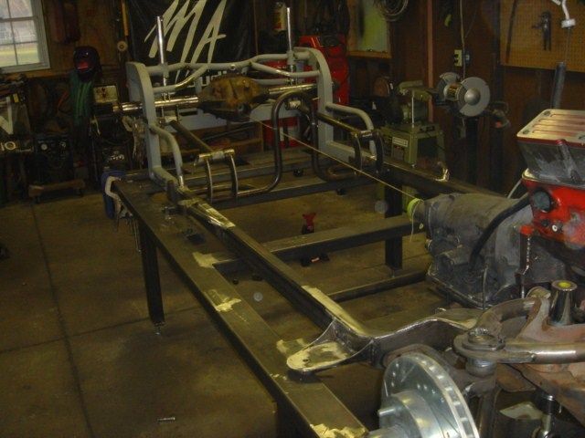

hey guys getting ready to start building my frame jig. just wantin to see some pics to get some ideas.

mines not really a jig....i dont think....

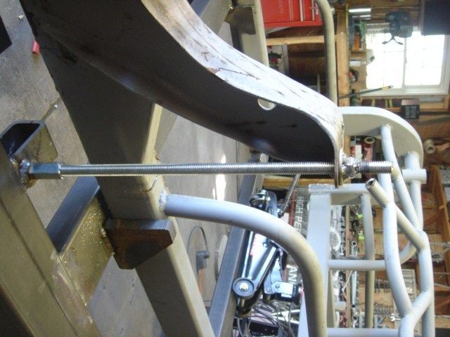

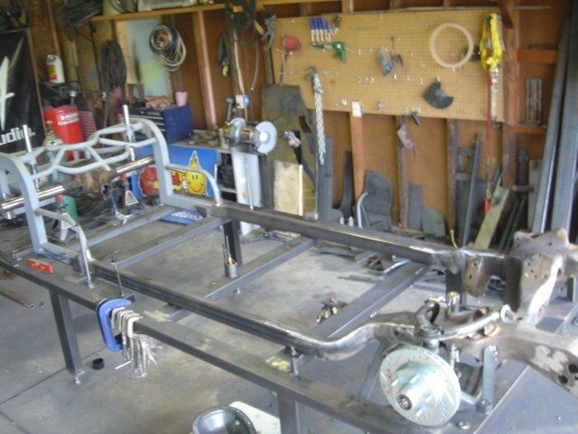

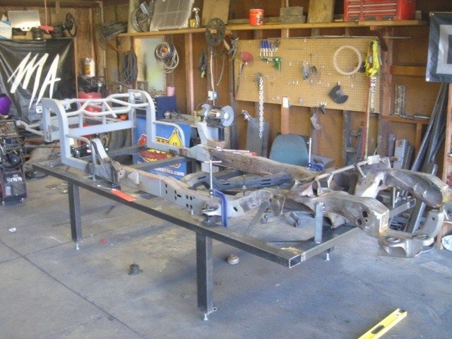

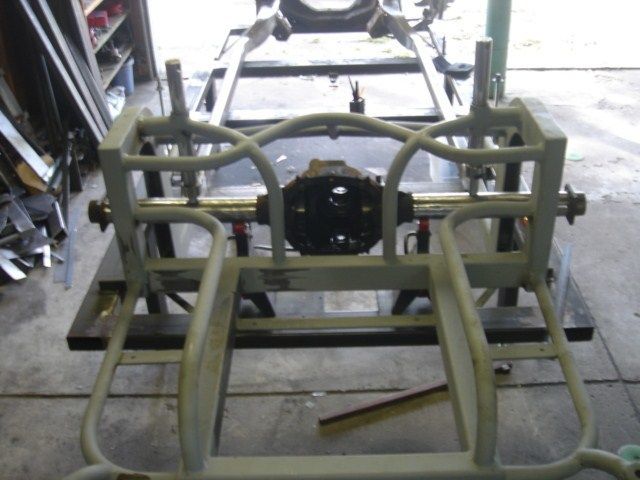

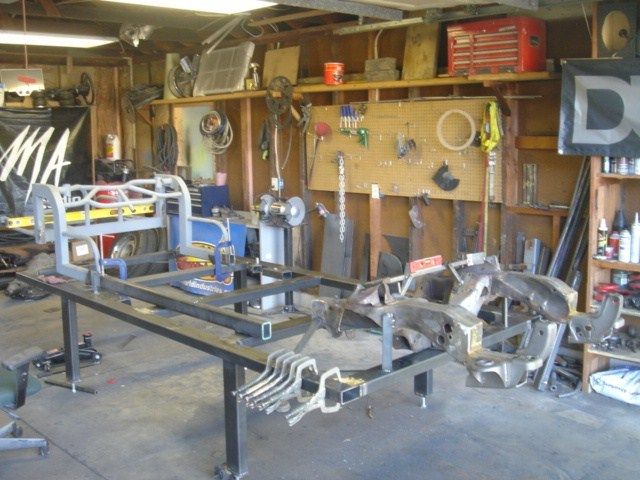

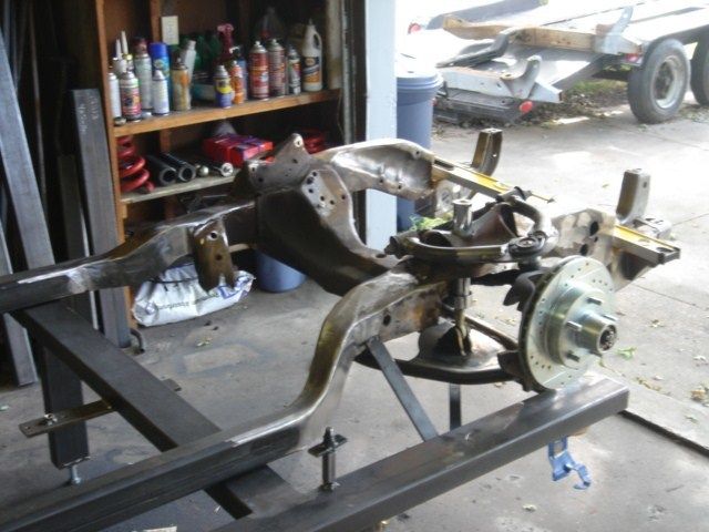

but heres my table. I welded nuts to the table below each body mount location, and ran threaded rod through the body mount and marked every thing with a washer at the stock height. Then just cut a spacer the amount of my bodydrop and put my new bodymounts at that location with the same threaded rod.
Its all 2x4 .125 wall. Its just long enough for my wheel base. It cost me a total of 125$ in materials, then i just welded it all up and leveled it out with the adjustable bolts on the bottom of the legs. It supports my SBC350 with no problem, just gotta add some gussets and legs to make it stable under more weight.
