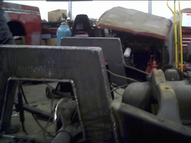

Isn't a toyota frame only 1/8"? Thats .125" and you only need 1 amp for every thousandth of an inch, so you could use the 135amp 110 volt machine and have a 10 amp buffer. A 50 amp buffer is perferd but you'll be fine.
framescr8pintoy's avatar
framescr8pintoy
itll work if you know what youre doing.. i did all mine with a 110 cause thats all i had access too. and i dont have any problems with my welds. of course im going to buy a 220 here in the future.
sadexcuse4s10
I do all my work at home (bag jobs, bodywork) with a Hobart 125
I stockfloored the '86 with a Miller 135 and it worked great on the 2X3 1/4" wall
so yes it can be done, and if you think it can't, then you need to rethink your welding expertise
